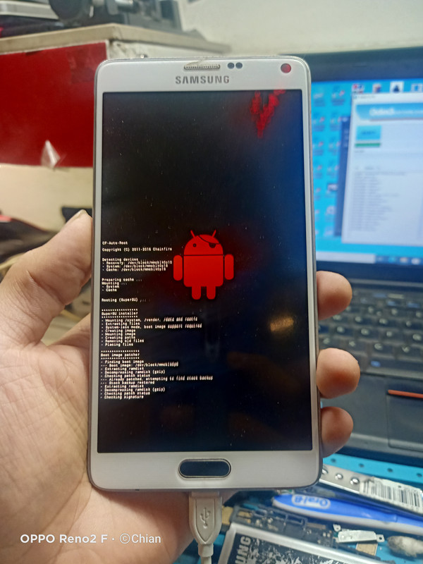

Magandang araw mga lods. Ako po ay may narecieve na unit samsung note 4 (SM-N910C) pag nag iinsert daw ng sim ay laging may lumalabas na unlock code sabi ko hindi yun openline at pag open ko globe lock nga.
Proceed napo tayo sa process.

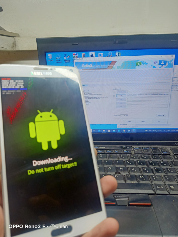

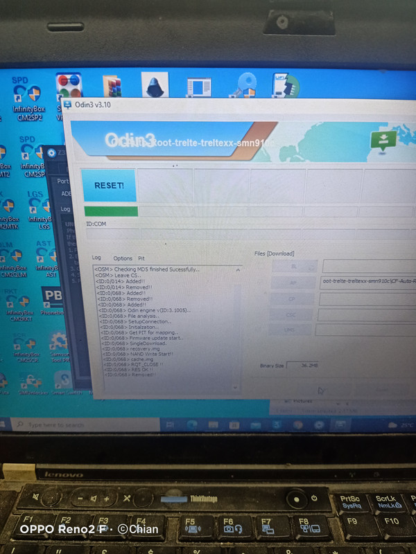

Open odin muna tayo dahil need pa i root at salpak itong file via AP https://www.mediafire.com/file/re2u9mcffal5vhl/CF-Auto-Root-trelte-treltexx-smn910c.zip/file

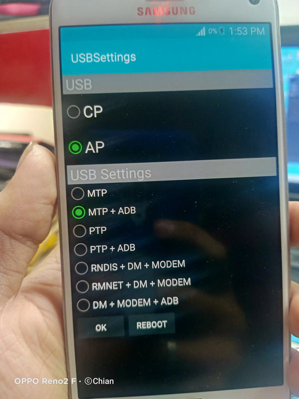

At dito dahil usb not recognize ang recieve ko dial *#0808# Piliin ang AP at MTP+ADB

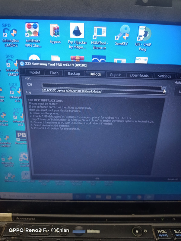

Select model then set adb

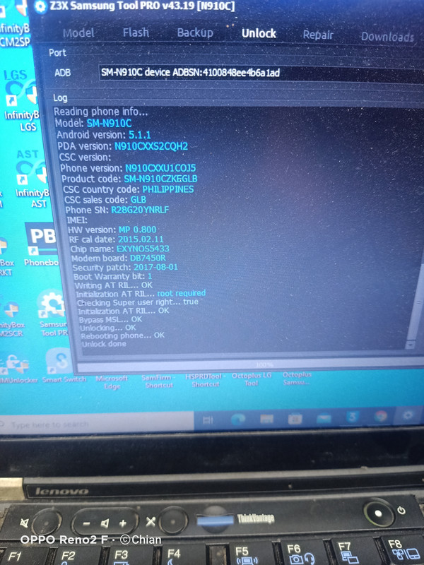

Now click unlock and wait matapos

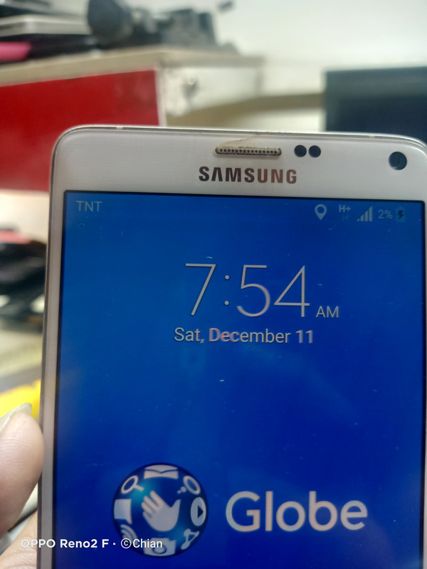

At heto naman po proof ko
upload picture
