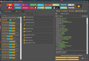

ONE CLICK SAMSUNG NOTE 10 Lite FRP UNLOCK DONE SUCCESSFULL ANDROID 12
Tools Needed
Unlocktool
Usb Cable
Procedure:
HardReset muna phone
1.Open Unlocktool
2. Select Tab Samsung
3. Go to Functions
4. Select Com Remove FRP (2022)
5. Dial *#808*#
6. Connect USB Done

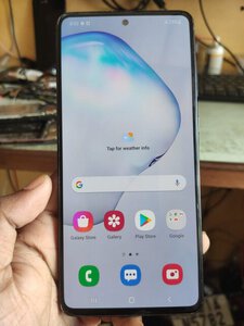

Wala bang pang android 13 sir? Sa note 10 lite?
