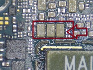

ung tatlong nabilugan sa picture saan kaya pwedeng ku

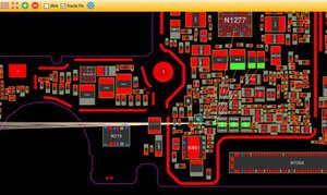

picture below is diagram both side are ground...
possible kayang yan ang problema ..
