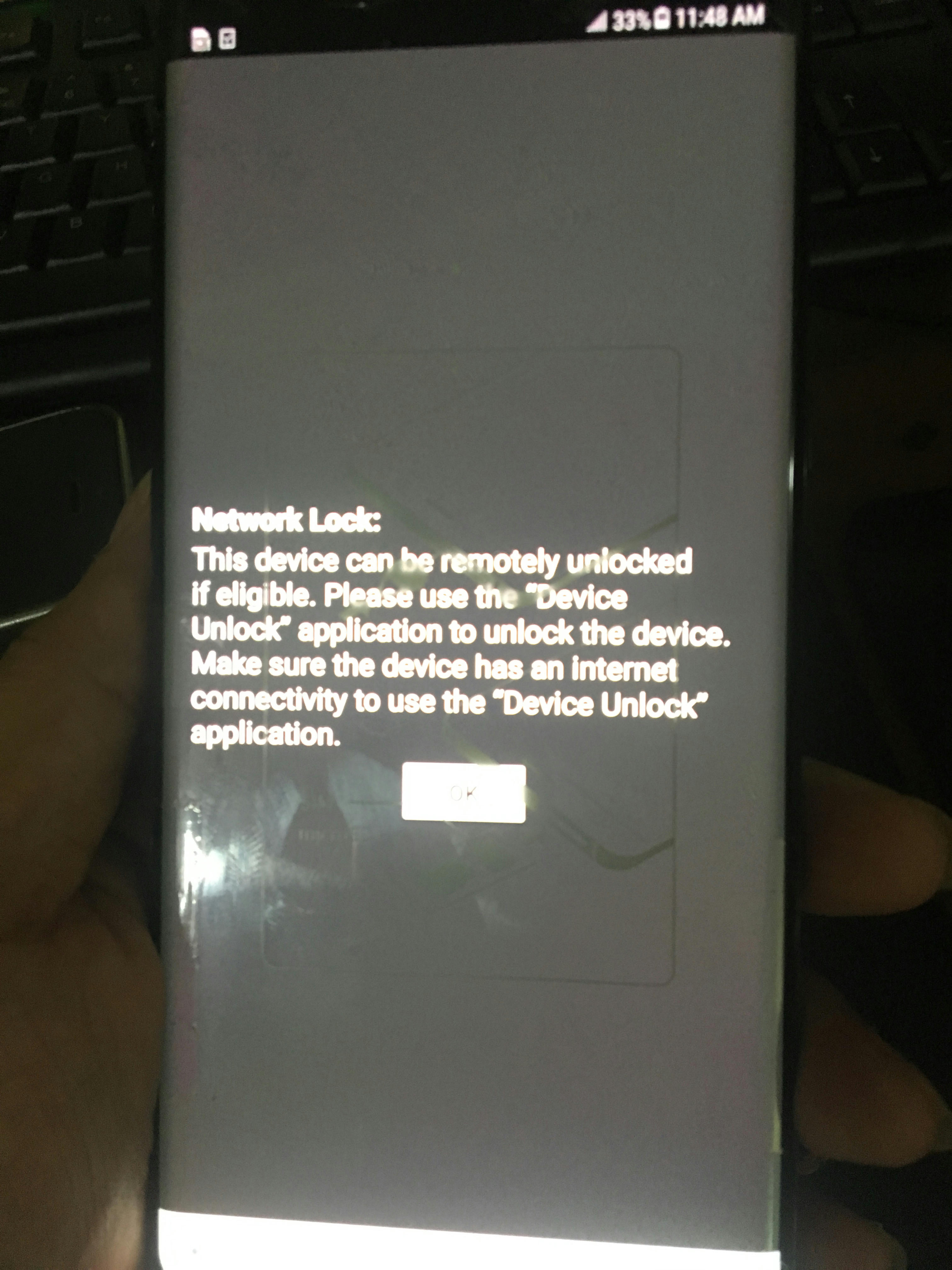

Samsung Note 8 (G950U) w/Unlock App T-Mobile Direct Unlock DONE
Tool:
Z3x Pro plus Credits (at dahil Nakalocked siya sa T-Mobile w/unlock app 10Crd po need natin)

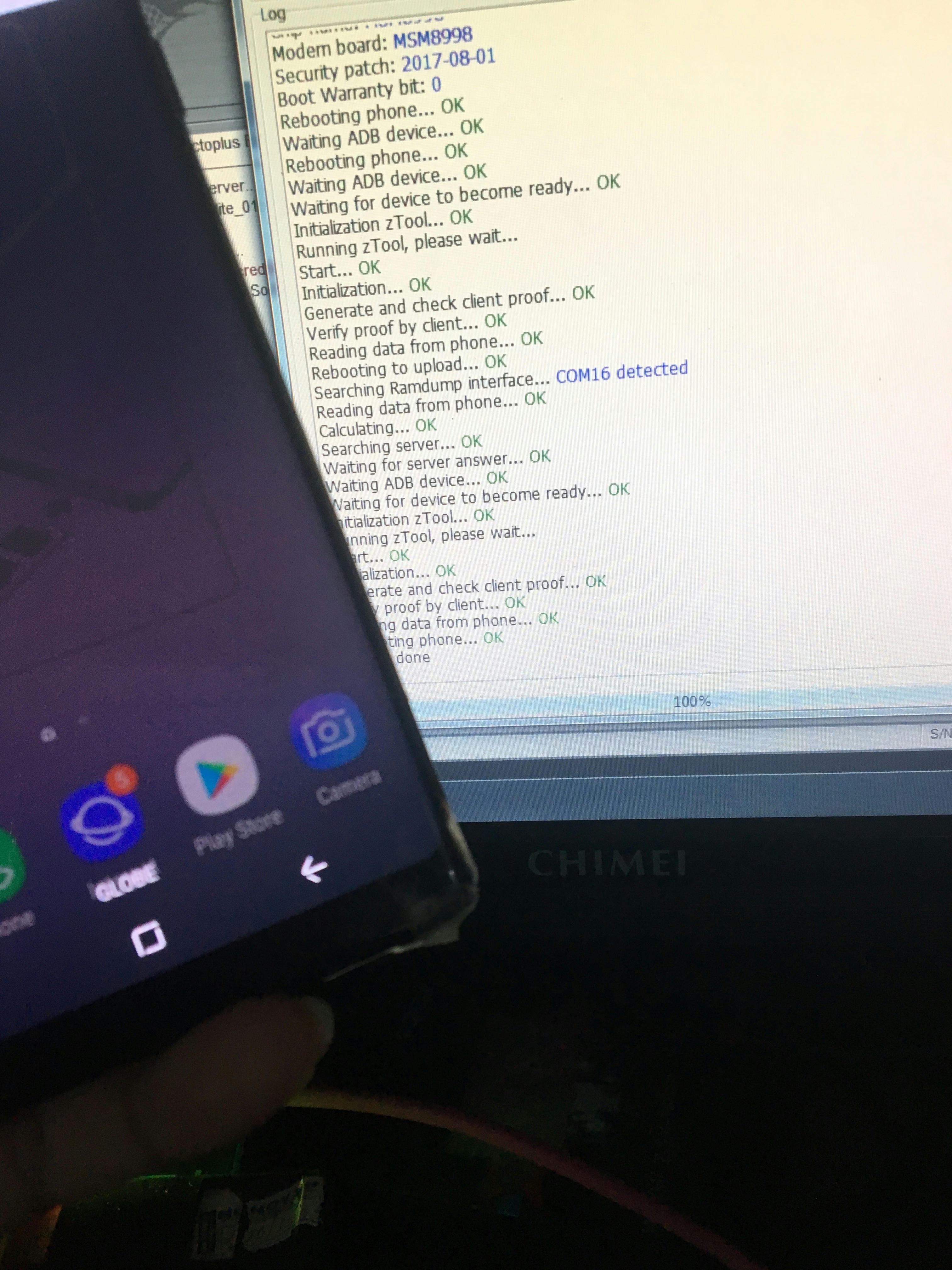

Unlocking using Server:
1. Power on the phone.
2. Tap 7 times on 'Build number' in 'Settings'-'About phone' to enable 'Developer options',
go to 'Settings'-'Developer options' and enable 'USB debugging'.
3. Connect the phone to PC with USB cable, install drivers if needed.
4. Select device in ADB settings.
5. Press 'Unlock' button for direct unlock, write your login and password in window if it will appear.
(Login and password will be saved as default after first input and can be changed in settings
Checking Login and Password... OK
Ballance: 25 crd.
You have 25 credit(s) left. This operation takes 10 credits.Continue? Yes
Waiting ADB device... OK

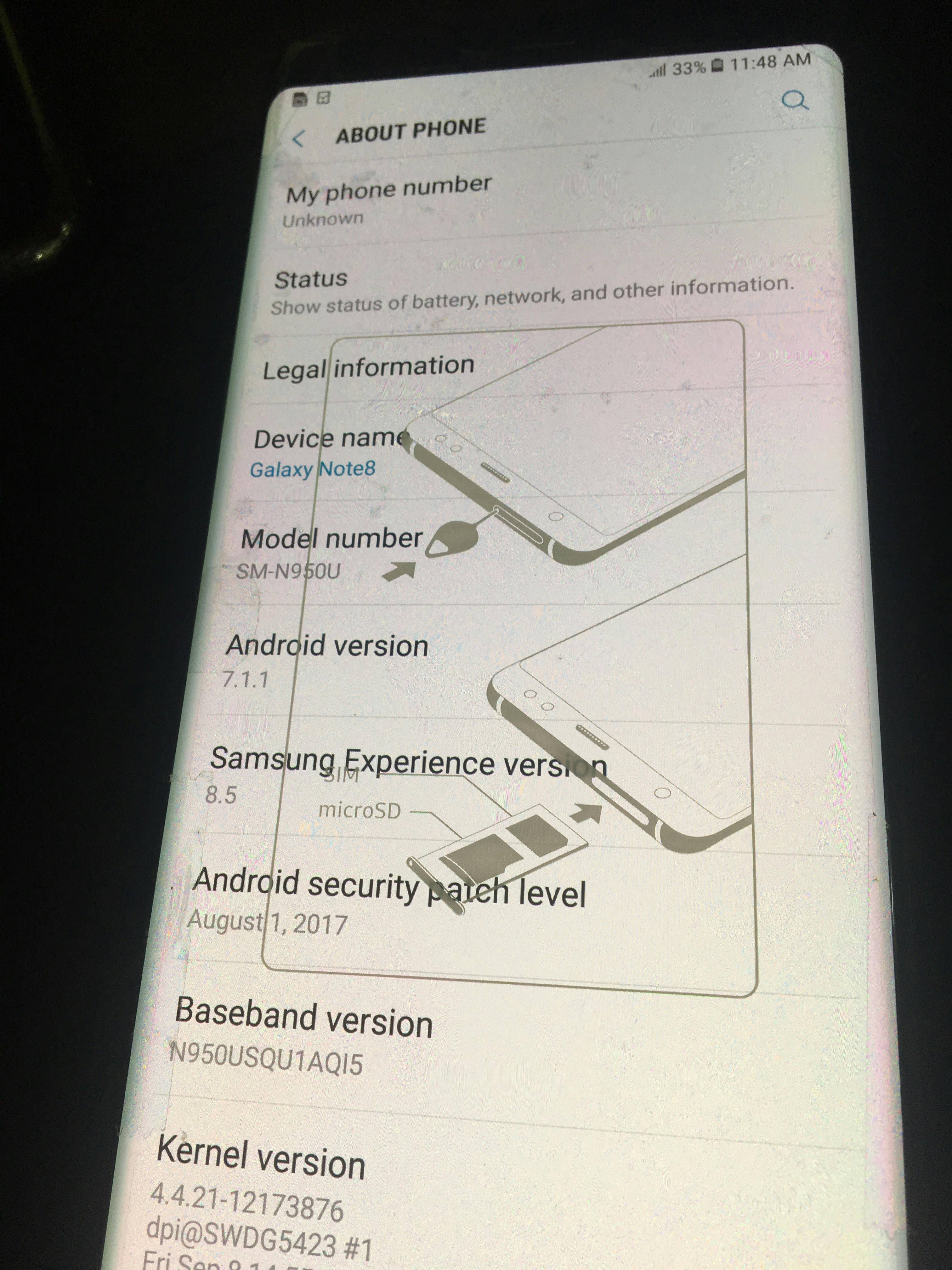

Reading phone info...
Model: SM-N950U
Android version: 7.1.1
PDA version: N950USQU1AQI5
CSC version: N950UOYN1AQI5
Phone version: N950USQU1AQI5
Product code: SM-N950UZKATMB
CSC country code: USA
CSC sales code: TMB
Phone SN: R28JA048MJB
IMEI: 35850508xxxxx81
HW version: REV1.0
RF cal date: 2017.10.10
Chip name: MSM8998
Modem board: MSM8998
Security patch: 2017-08-01
Boot Warranty bit: 0
Rebooting phone... OK
Waiting for device to become ready... OK
Initialization zTool... OK
Running zTool, please wait...
Start... OK
Initialization... OK
Generate and check client proof... OK
Verify proof by client... OK
Reading data from phone... OK
Rebooting to upload... OK
Searching Ramdump interface... COM16 detected
Calculating... OK
Searching server... OK
Waiting for server answer... OK
Start... OK
Unlock done
eto Done my GLobe n siya
