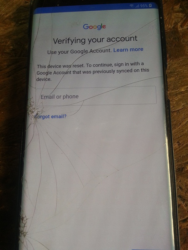

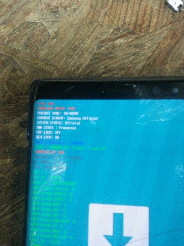

share ko lang po mejo pinahirapan ako n2 Note 8 po oreo n ung version
tpos binary 5 po..
e2 po nung tanggap ko

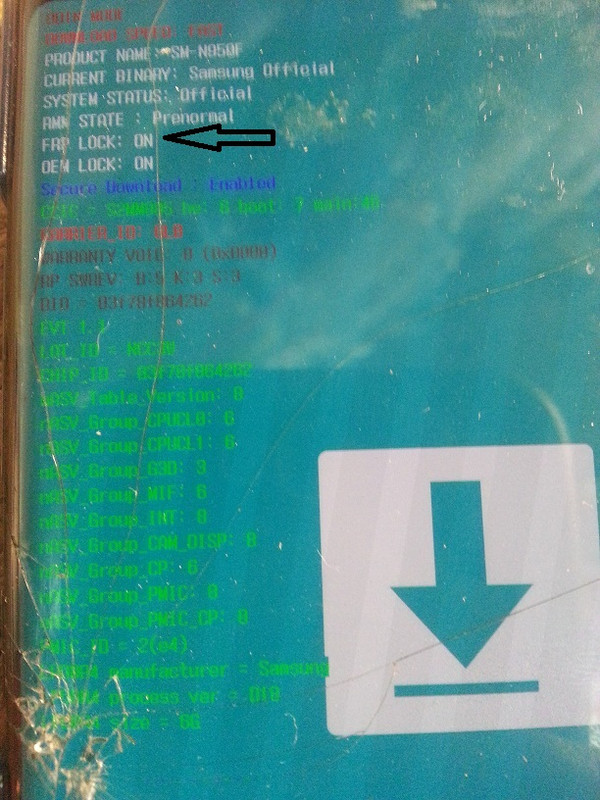

yan po nkaon p FRP

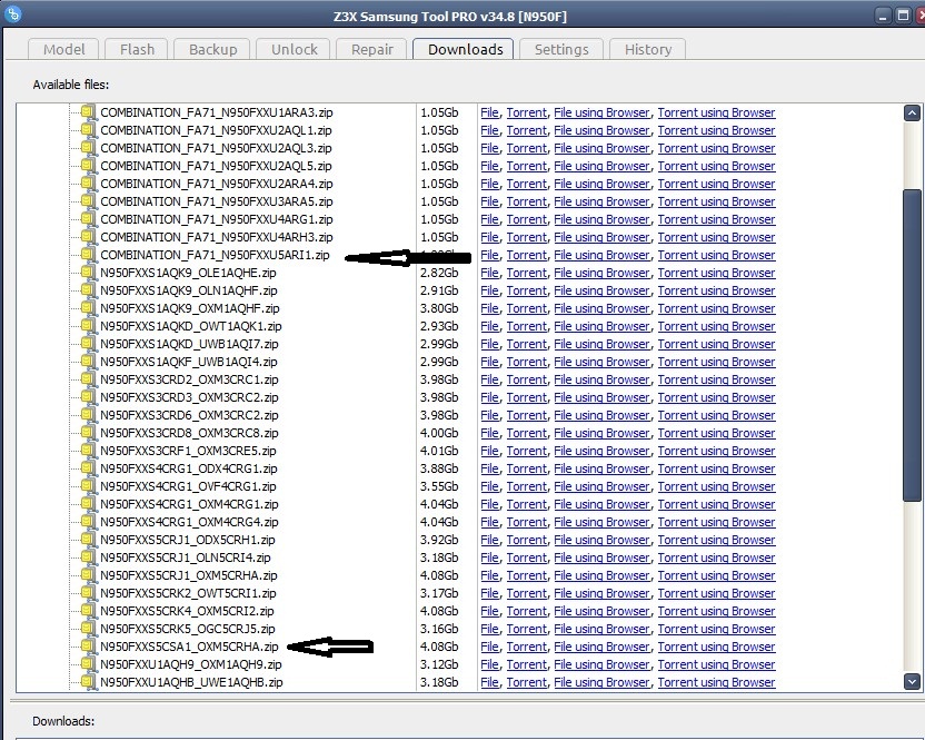

1. download muna s support ng mga kailangan n files

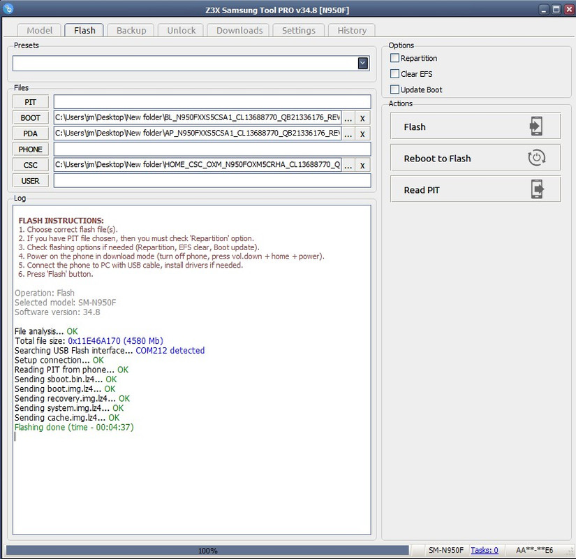

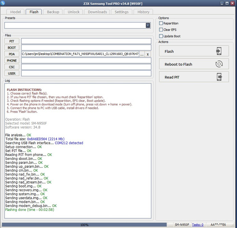

2. flashing po muna ng combi
3. after po flash ng combi wag po muna ifull flash ksi on p rin FRP nyan

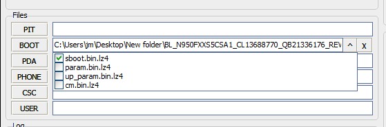

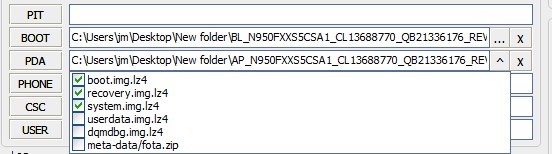

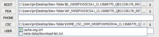

e2 po gwin select files s Boot, PDA at CSC
at lagyan lang ng check ung iba gya ng nsa picture:
4. flash nyo n po

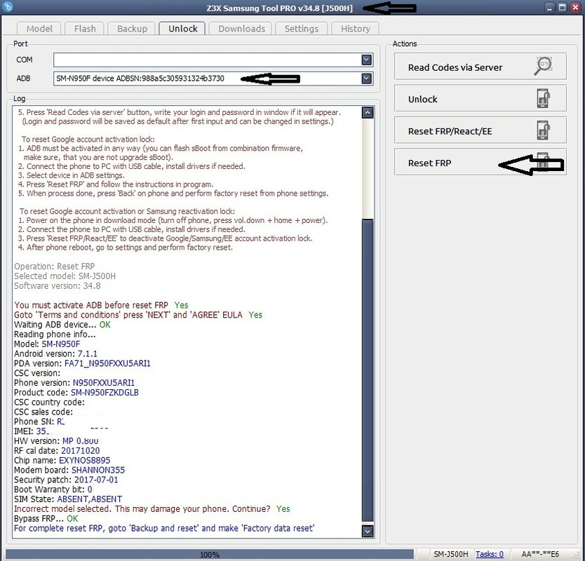

5.after nmn po nun mkkpunta kn ng menu open developer settings
open usb debugging at ireset ang frp
sken po ginamit kong ung reset ung j500h n model s Z3X

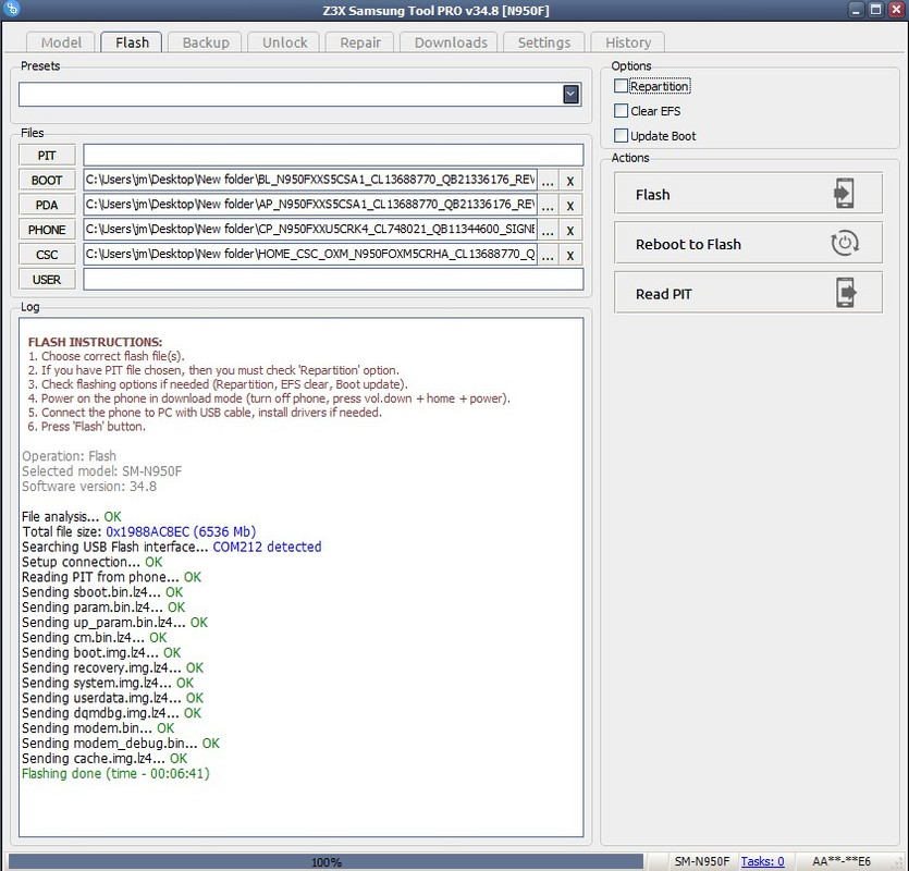

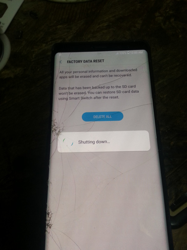

6. after po nyan factory reset nyo n po s settings pra ma-off n frp nya
note: hang logo po after reset po hang logo yan ksi n ndi p n full flash
pero ok lng yan download mode lang po ulit at full flash pra mag OK

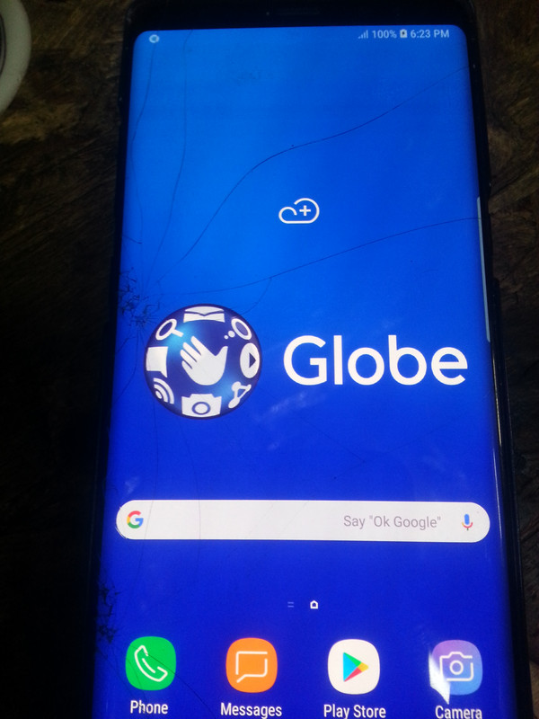

e2 po off n FRP
flashing...
done
sna po mkatulong s inyo
