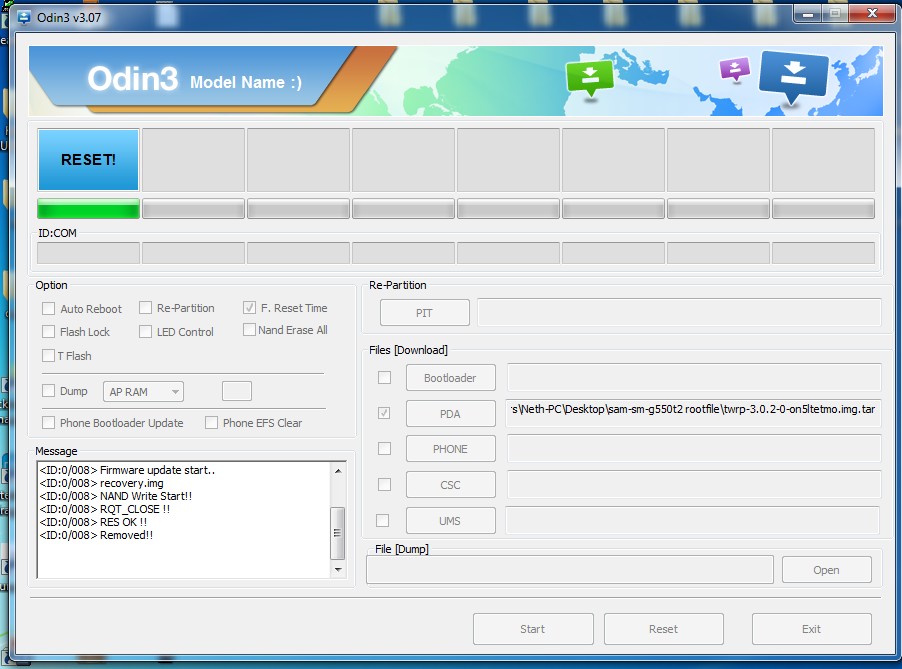

2nd open si odin at ilagay sa PDA

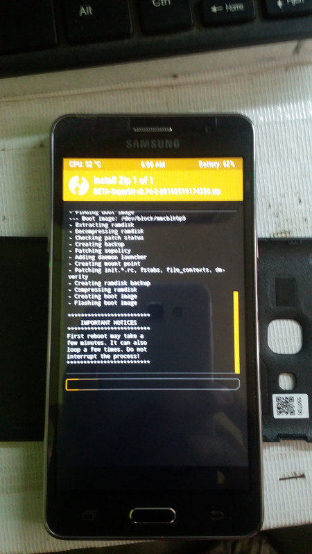

3rd pagkatapos ma root copy si BETA-SuperSU-v2.74-2-20160519174328.zip sa Sd Card

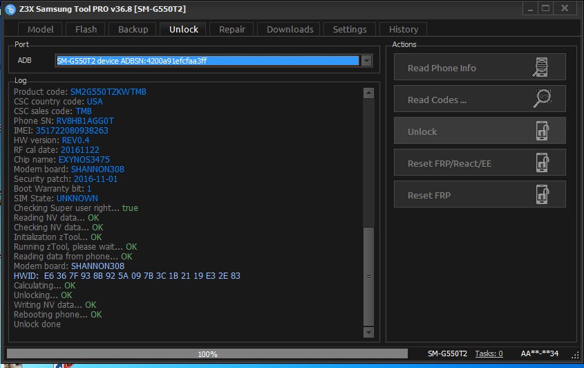

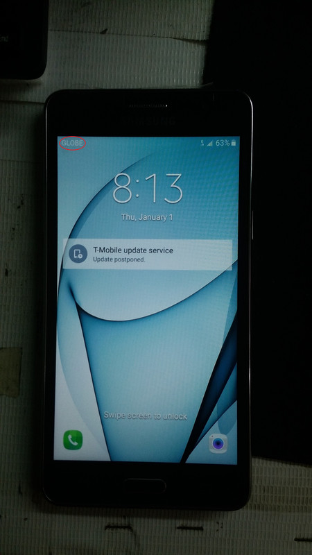

4 after ma installed reboot ang phone ready na para unlock open z3x tools click unlock done

nearest exxon mobil station4 after ma installed reboot ang phone ready na para unlock open z3x tools click unlock done
