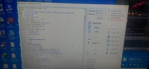

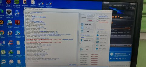

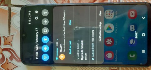

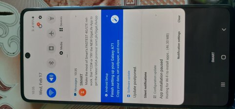

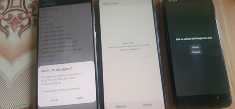

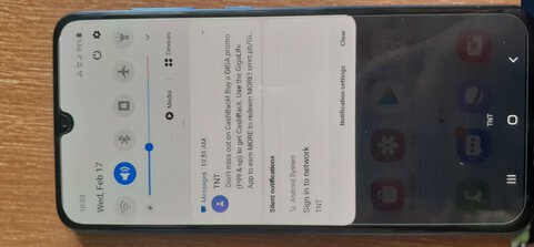

share ko lang mga boss master 3pcs samsung naka region lock lahat support naman po siya sa samkey.org
MODEL:
1 SM A705FN/DS
1 SM A715F
1 SM A202F/DS
PROCEDURE:
1 open samkey tools
2 usb debugging on
3 dial *#0808# then select DM+MODEM+ADB
4 insert cable usb (naka on po dapat ang phone)
5 read info
6 read codes
7 wait finishing process then done
