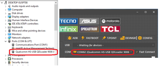

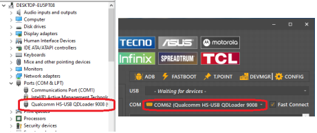

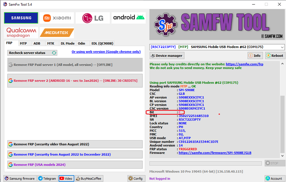

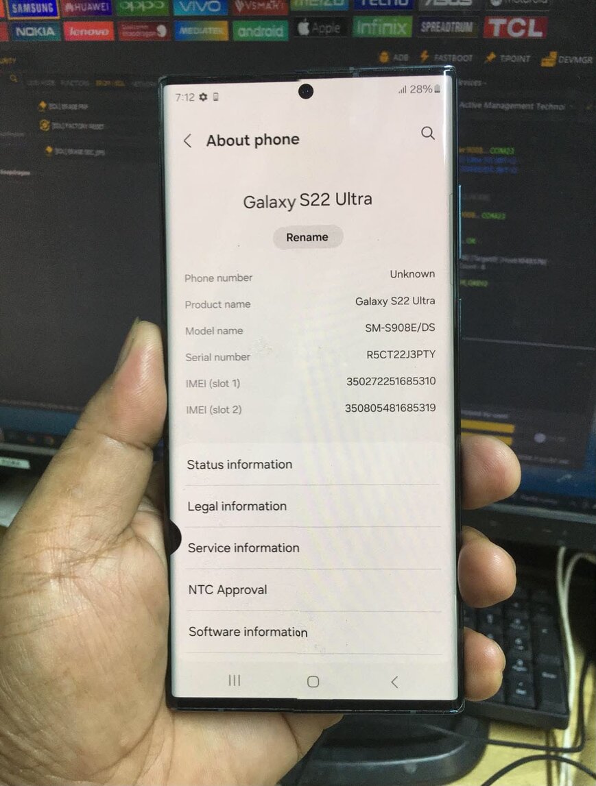

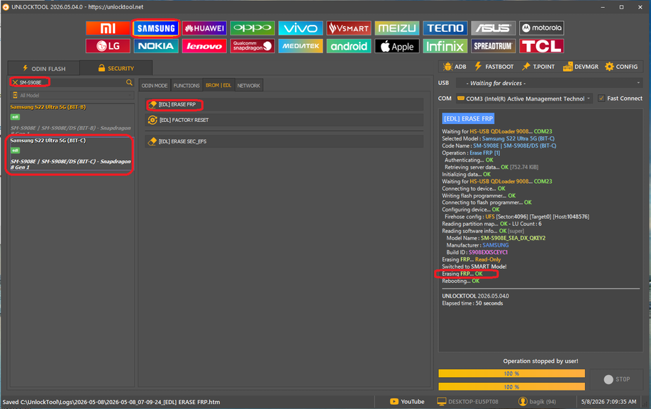

bagik Registered Joined Jun 12, 2014 Messages 490 Reaction score 428 Points 71 Location Bignay Valenzuela City May 8, 2026 #1 mtp info by SamFwTool boot key modified edl cable before insert cable hold volume up&down then press the switch 4times fast now phone in qualcom mode change normal cable and hit erase frp done Last edited: May 8, 2026

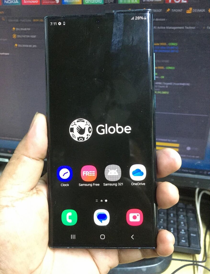

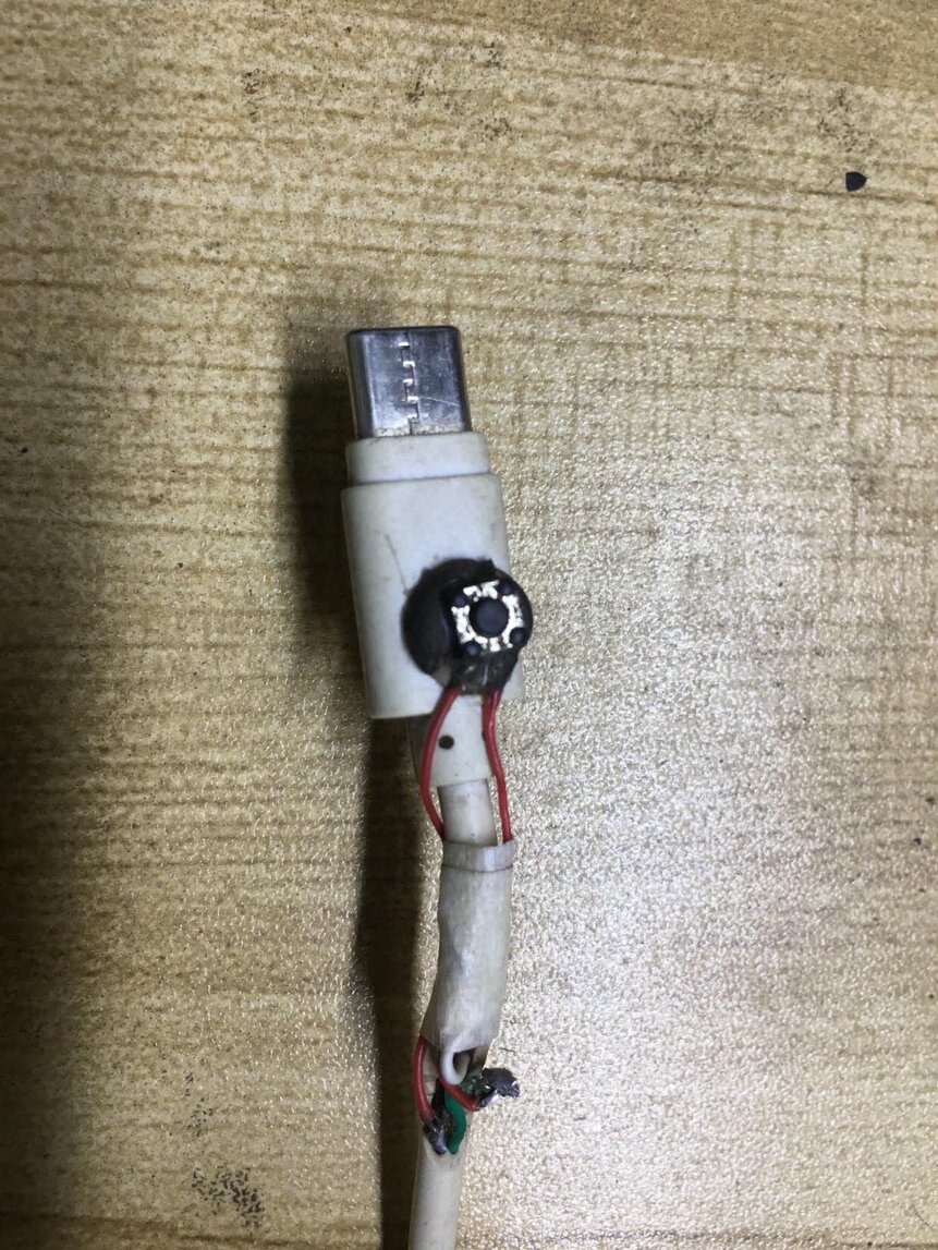

larstech30 Registered Joined Nov 5, 2025 Messages 118 Reaction score 260 Points 1 Location quezon city May 8, 2026 #2 bagik said: mtp info by SamFwTool View attachment 41004 boot key modified edl cable before insert cable hold volume up&down then press the switch 4times past View attachment 41005 View attachment 41006 now phone in qualcom mode View attachment 41007 change normal cable and hit erase frp View attachment 41008 done View attachment 41009 View attachment 41010 Click to expand... tested yan sir hito naman sakin

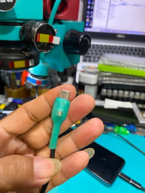

bagik Registered Joined Jun 12, 2014 Messages 490 Reaction score 428 Points 71 Location Bignay Valenzuela City May 8, 2026 #3 larstech30 said: tested yan sir hito naman sakinView attachment 41011 Click to expand... ganda ng pagkagawa mo sir sa modified cable
