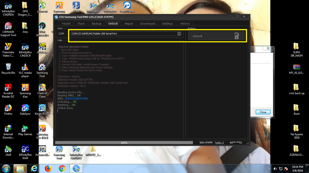

share ko lang gawa ko ngayon mga boss sgh-i747m unlock done sa z3x tool pro..pacensya na po kung matagal tagal na ako di nkapagpost kasi galing po ako sa bakasyon at ngayon lang po ako nkabalik...
procedure..
[QUOTE
1. Phone must be powered on.
2. Type *#0808# and select 'DM+MODEM+ADB'.
3. Type *#9090# and choose USB (or 'DM/DUN over HSIC').
4. Reboot phone.
5. Connect USB cable, install drivers if needed.
6. Select Samsung diagnostic port in port settings.
7. Press 'Unlock' button for direct unlock.
Done with Samsung Tool PRO v.35.2
][/QUOTE]
pics..
DONE...

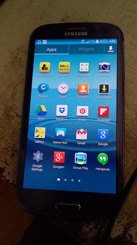

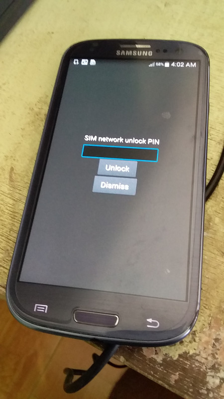

pics..
DONE...
