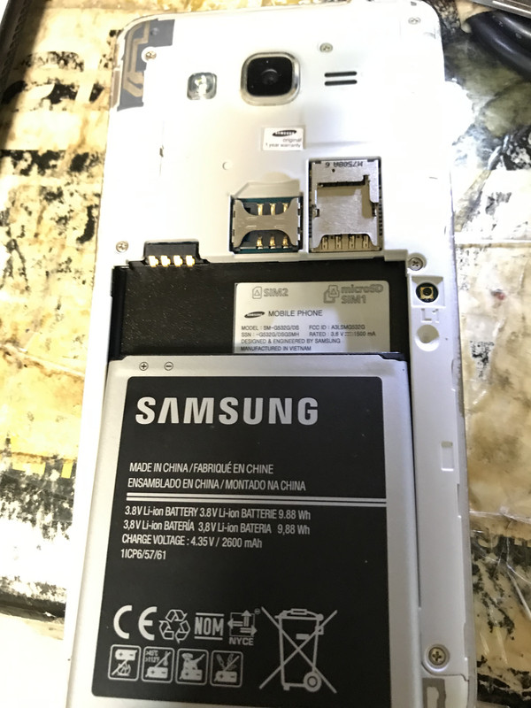

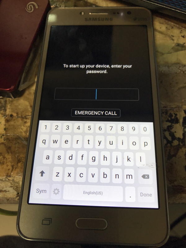

GOOD DAY MGA KA ANTTECH SHARE KO LANG GAWA KO NEW BYPASS FRP/GOOGLE ACCOUNT J2 RIME
VIA ODIN AND COMBINATION FILES
PAKISUNDAN LANG PO ANG PROCCEDURE

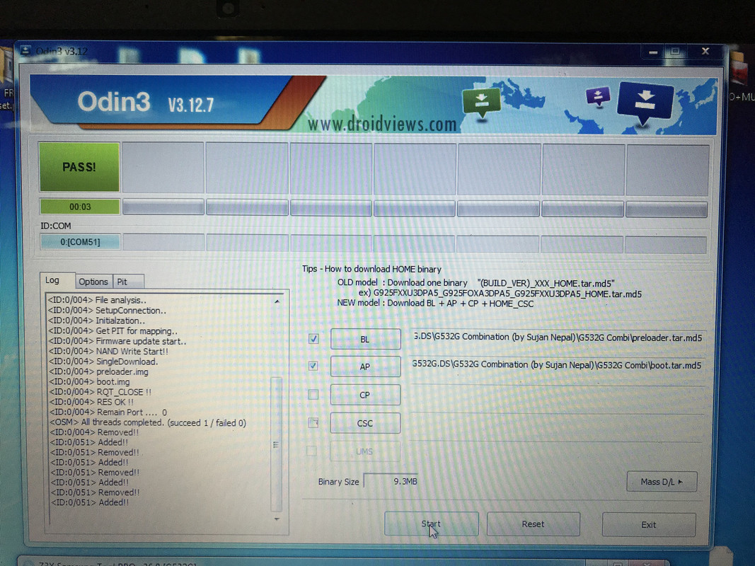

1. DOWNLOAD MO NA COMBINATION FILES HERE
https://drive.google.com/file/d/0B0qpi9-i-aRcSk1RUmhwTHJlWWM/view
2. EXTRACT FILES
OPEN ODIN LOAD BL AND AP FILES
FLASH/CLICK START
3. FLASHING DONE ITO NA ANG KALABASAN PAGKATAPOS

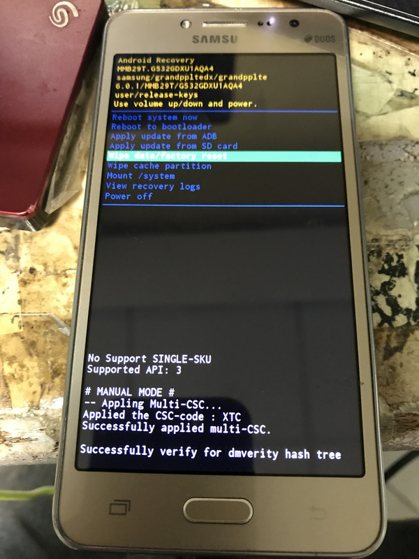

4. GO TO HARD RESET ANG PHONE PRESS AND HOLD VOLUME + AND HOME BUTTON + POWER
ITO NA SYA AT ALAM NYO NA KNG ANO ANG E SELECT

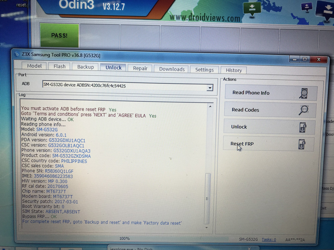

5. OPEN Z3X BOX O ANONG BOX GAMIT NYO PANG BYPASS FRP
SELECT ADB AND HIT RESET FRP

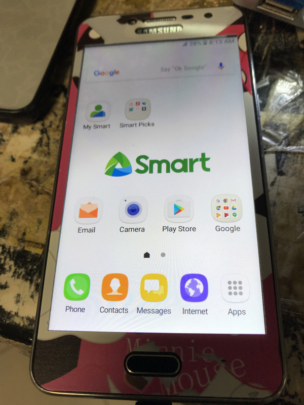

DONE NA .SIMPLE BASTA WISE KA AHAHAHA...
SANA MAKATULONG SA LAHAT ANG GINAWA KO AT SANA MAGING MAAYOS ANG PAGGAWA NG ATING THREAD POST PRA MAITINDIHAN PA AT MAAYOS
