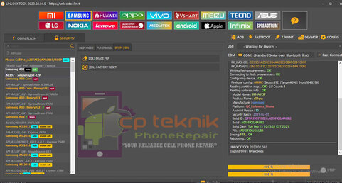

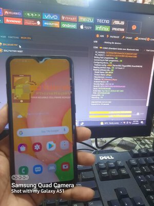

I. open unlock tool
2. select samsung, search samsung A015f

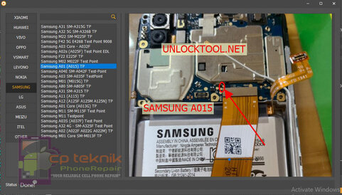

3. click BROM/EDL
4. Open Test Point Tab. (hanapin mo ang SM-A015f sundan mo lang anu instruction)
5. click EDL ERASE FRP need testpoint
6. Gamit ka twizzer test point ---> saksak usb cable

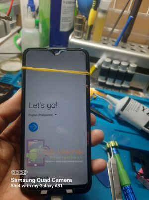

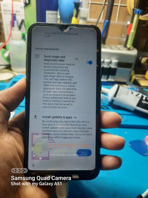

SEE PHOTOS BELOW
