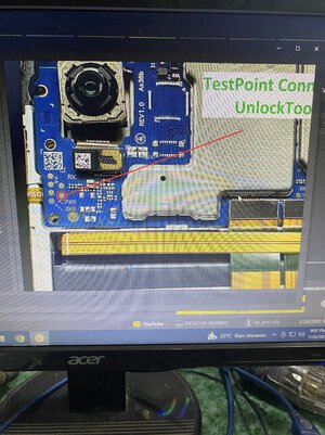

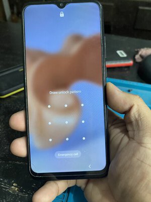

1. hardreset muna.
2. open unlocktool piliin ang samsung a035
3. select erase frp
4. open ang backcase look for the testpoint.
(dapat naka connect ang battery mag testpoint).
5. done

ok naman sa akin boss kahit nakatanggal ung battery safe po kasi pag nakaremove

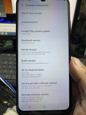

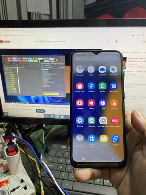

ito po logs:
[SPRD] ERASE FRP Selected Platform : Tiger T606_64_Bypass
Connect Testpoint or hold VOL DOWN! Instruction here!
Waiting for device... COM18 (SPRD U2S Diag)
USB : USB\VID_1782&PID_4D00\5&32DBFA55&0&3
Initializing loader... OK
Protocol : SPRD3
Sending payload... OK
Sending auth data... OK
Sending preloader1... OK
Sending preloader2... OK
Booting loader, please wait... OK
Boot ver: Spreadtrum Boot Block version 1.1
Sending FDL1... OK
Sending FDL2... OK
Reading partitions info... OK
Reading device info... OK [super]
Model Name : SM-A035F
Product Name : a03nnxx
Manufacturer : samsung
Android Version : 13
Security Patch : 2022-11-01
Build ID : TP1A.220624.014.A035FXXU2CWA5
Build Date : Fri Jan 6 17:04:00 KST 2023
Code Name : SM-A035F
PDA : A035FXXU2CWA5
Erasing FRP... OK
Erasing FRP... OK
UNLOCKTOOL 2023.08.29.0
Elapsed time : 1 minute 8 seconds
