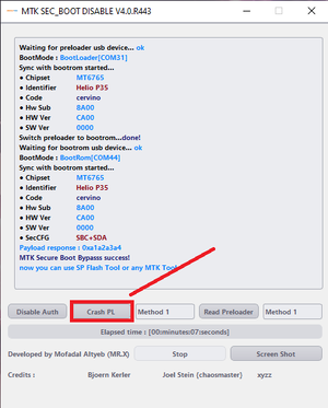

open MTKSecBootDisable
run mtksecbypass
click Crash PL
saksak usb para sa driver no boot key saksak lang

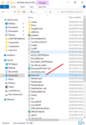

pag naka mtk driver na open flash tool na

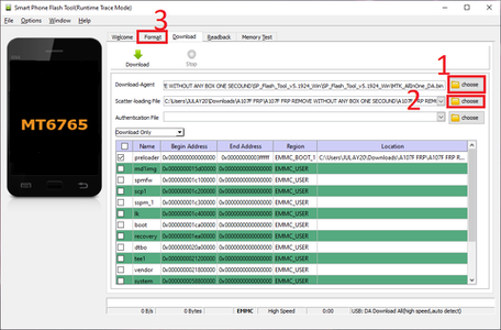

open flash tool
load MTK_All_IN_ONE_DA.bin
load MTK_Android_scatter.txt

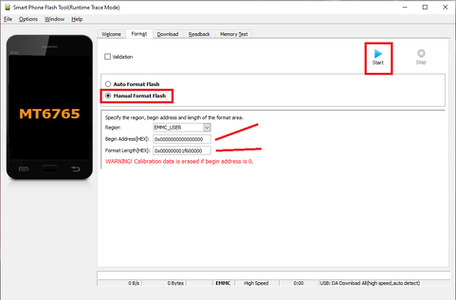

click format
Select Manual Format Flash
Then, Copy and Paste the below FRP Address into the SP flash tool Whatever you need
yung Address na sa folder ng na download mo

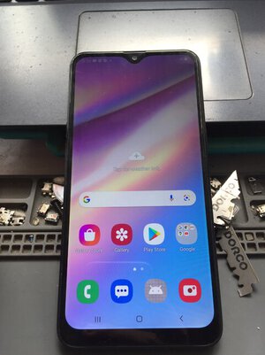

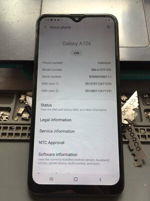

ito unit :
