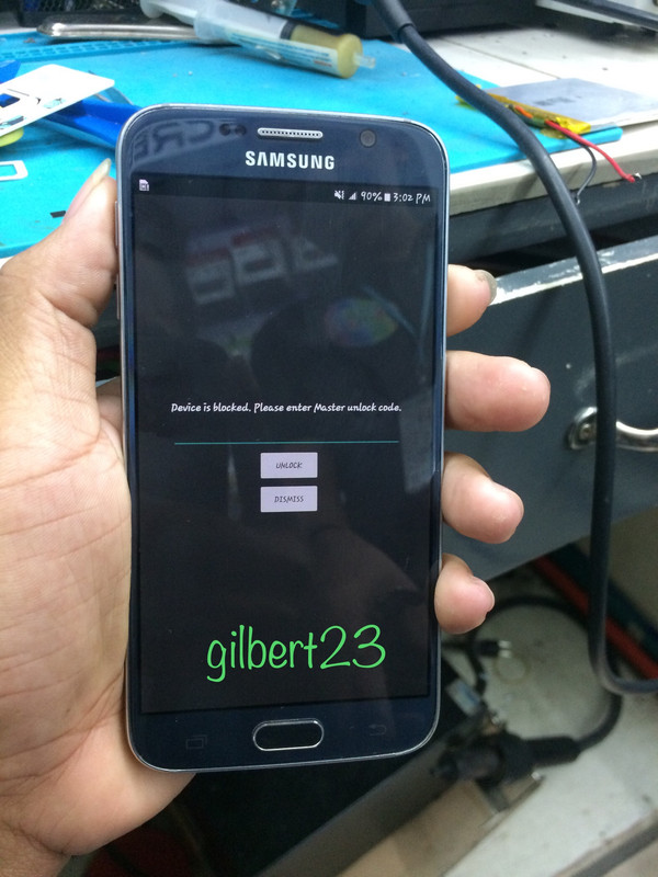

Samsung SM-g920W8 History;Humingi unlock code
Proceed agad ako unlock

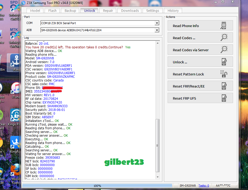

Procedure;z3x pro v34.8 latest

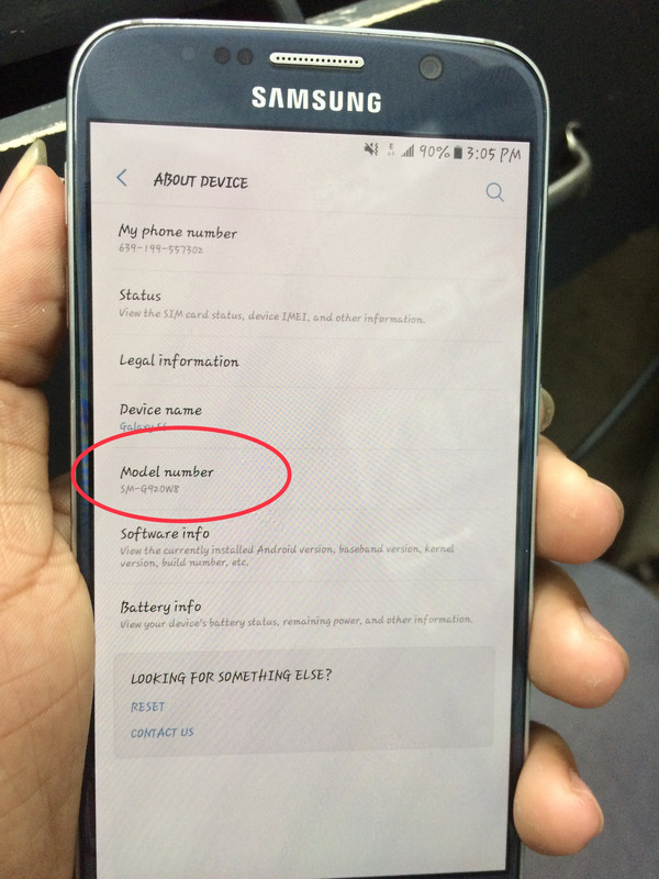

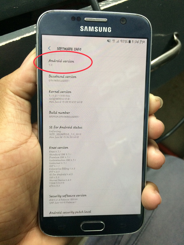

Open Phone setting tap build number 3x and open developer
Off oem check debug dial *#0808# select DM+ACM+ADB salpak phone
thick read codes via server 0 credits basta may balance box nyo,kitang kita naman sa picture​
wait until done

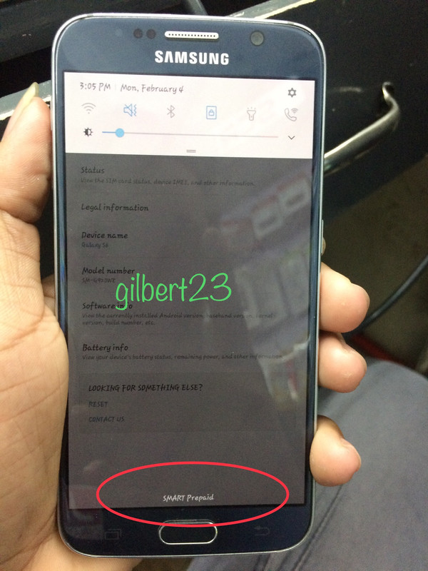

Ayan na po 800 lang :))​
