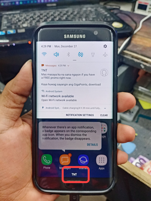

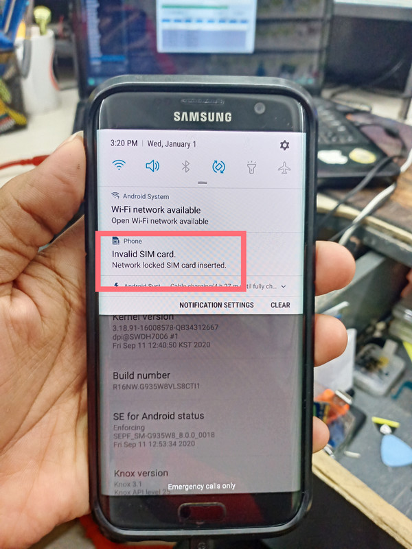

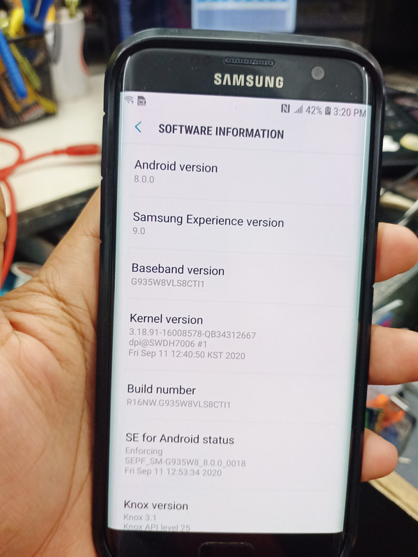

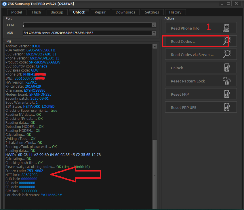

G_Iph2022 Expired Account Joined Jan 12, 2016 Messages 111 Reaction score 79 Points 221 Location roxas city capiz chapter Jan 14, 2022 #1 SM-G935W8 LOCK STEP.1 OPEN Z3X STEP.2 ROOT PHONE 2X SABIHIN SI TUMER DELETE ALL FILES ROOT FILE (RUN ODIN/FLASH AP) UNANG ROOT HINGI RESET/RESET NYO LANG KALAWANG ROOT MAG SUCCESS NA PO/READ CODE NYO VIA Z3X ITO PATUNAY ITO NAGKA SIGNAL NA SANA MAKA TULONG
