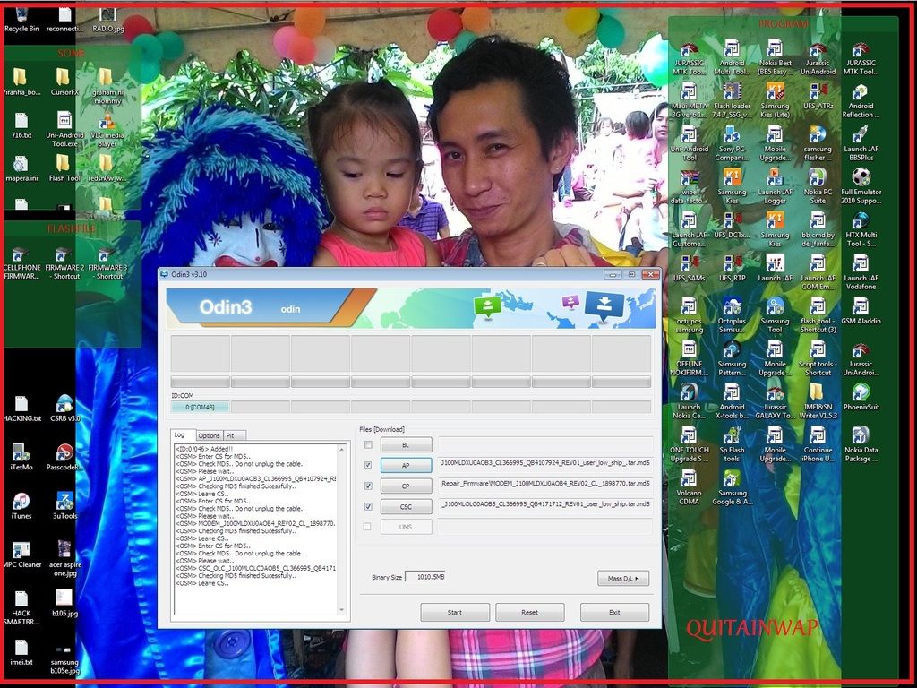

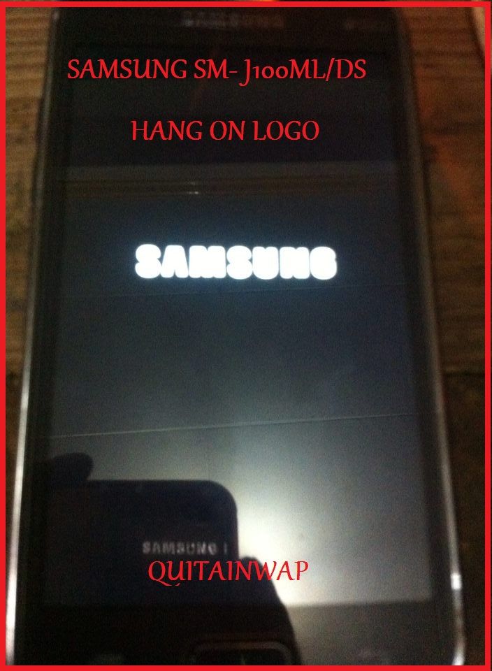

Good day guys samsung sm - j100ml/ds hang on logo
first procedure hard reset muna but no luck

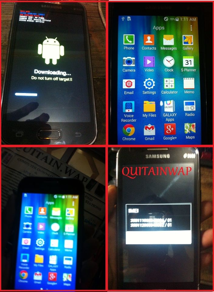

put phone in download mode by pressing and holding vol- + power + center button
and press vol up to continue
salpak c samsung sa micro usb to pc
install driver if needed
SAMSUNG SM - J100 ML/DS REPAIR FILES (4 FILES FIRMWARE + PIT)
WITH PASSWORD
pm me for password
open odin 3 v3.10.6
load AP, CP and CSC ONLY for safe flashing alam nio na iwas deadboot after flash
dapat nababasa ang com port and press start until flashing finish
done​

Ayos po boss quitainwap salamat sa thread mo pasubok sa firmware mo boss at pwede din po sa pass salamat po
1010 percent tested, sana po wag na ntin pilitin pang gamitin ang full files nito para hindi po tau mkadead boot, ung 2 files lng ok na ok na po... salamat.
