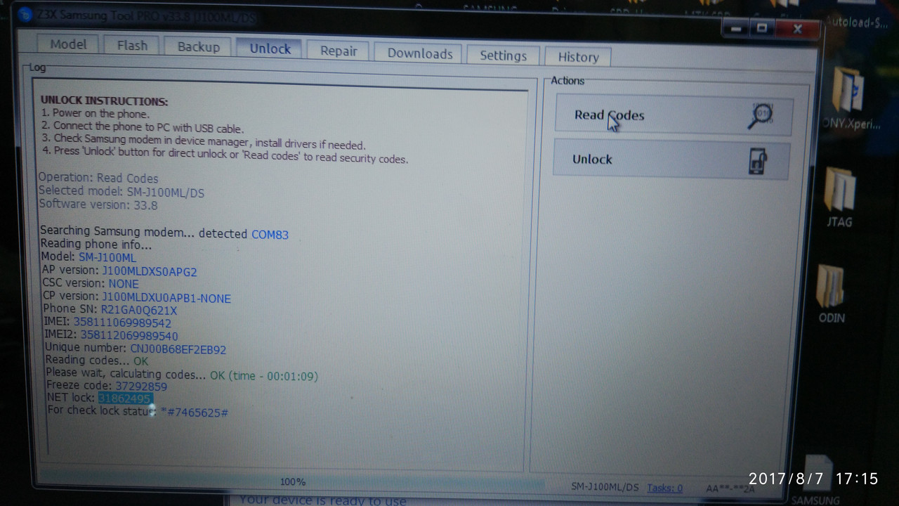

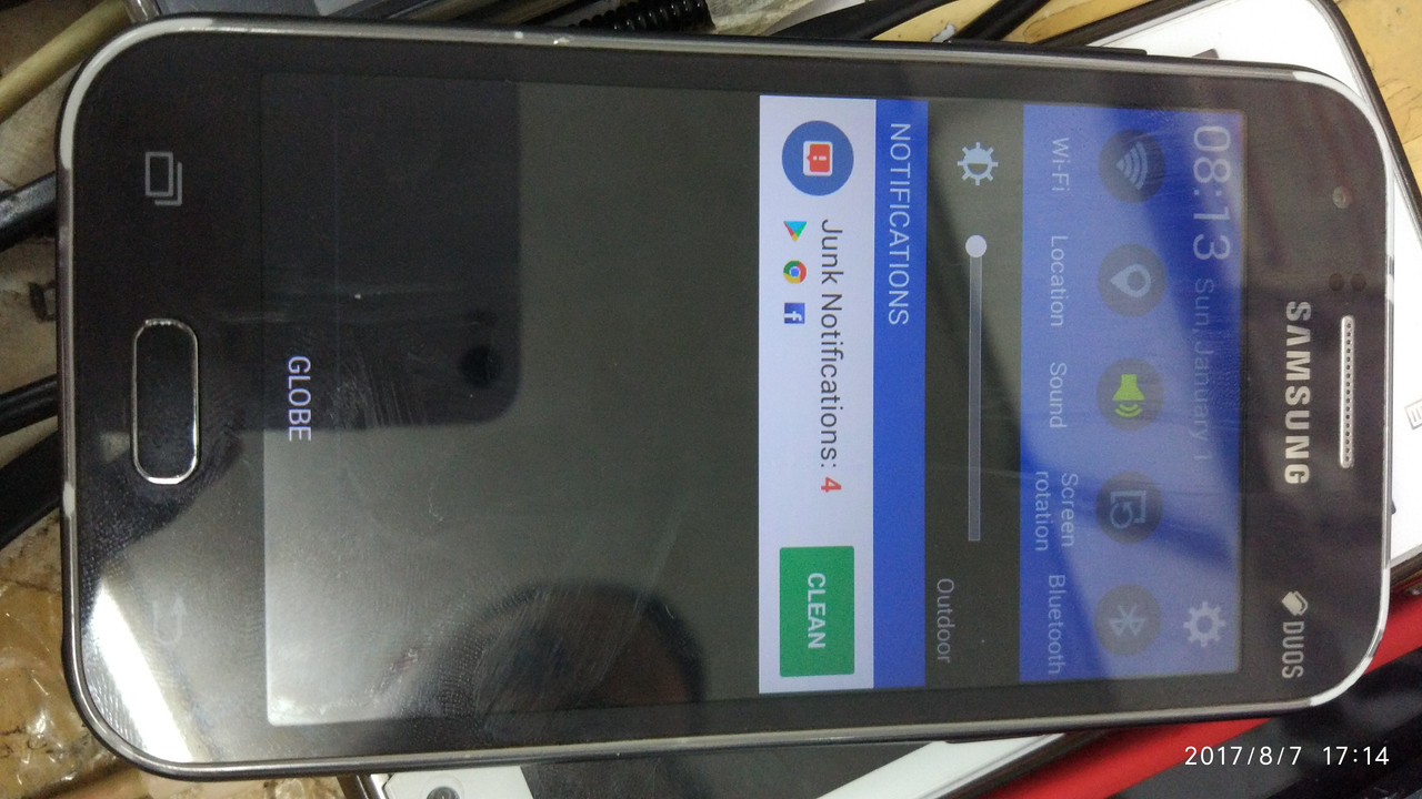

GOODAFTERNOON SHARE KO LANG GAWA KO J100ML/DS NOT OPENLINED
KAYA GINAWA KO UNLOCKED GAMIT ANG MAHIWGANG Z3X BOX
1. OPEN Z3XBOX TOOL
2. SELECT MODEL
3. INSERT USB CABLE DAPAT NAKA ON ANG PHONE
4. GO TO SETTINGS SELECT DEVELOPER OPTIONS,ON OEM unlock and ON USB debugging
5.CLICK READ CODES
6.WAIT UNTIL MATAPOS BASAHIN..
7.TYPE 8 digits Para unLocking...
"NETWORK SUCCESSFULL"
DONE: SANA MAKATULONG SA TAHANAN...(l:0
