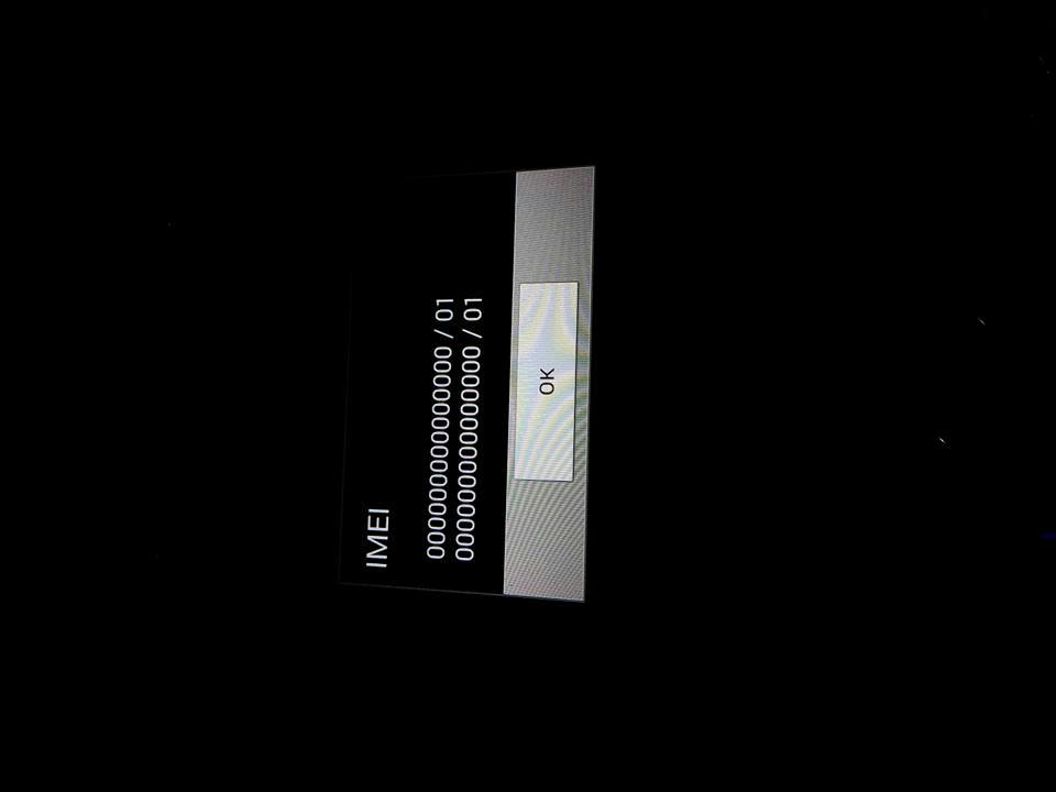

Deadboot after flashing

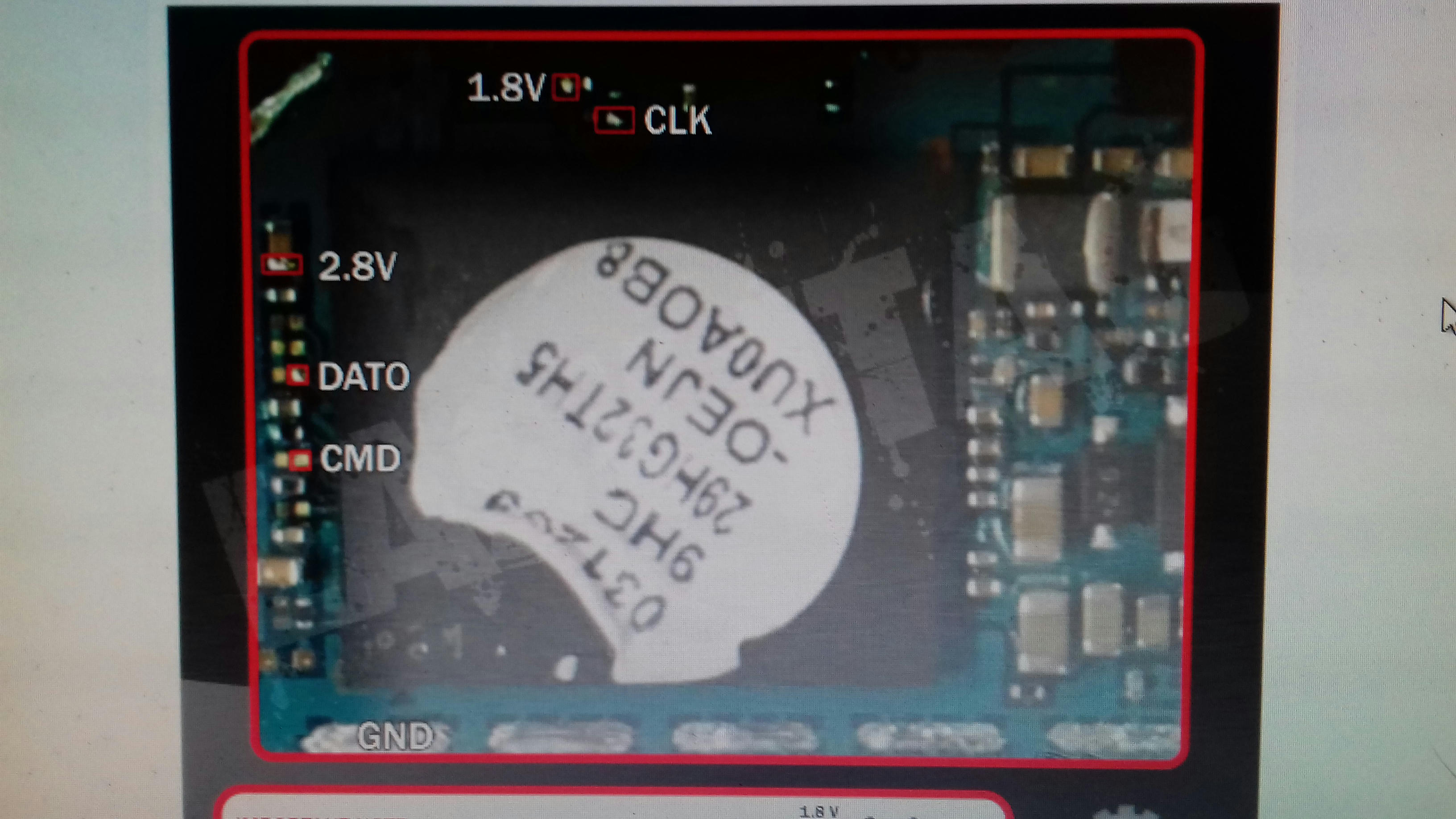

pinout diagram

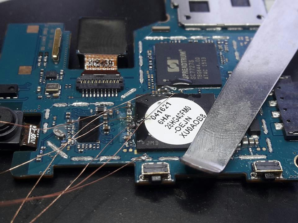

soldiering the pin out line

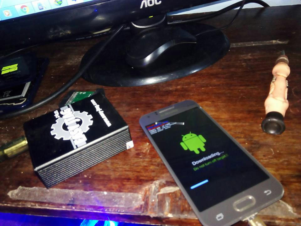

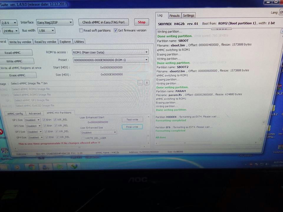

open easy jtag plus and flash

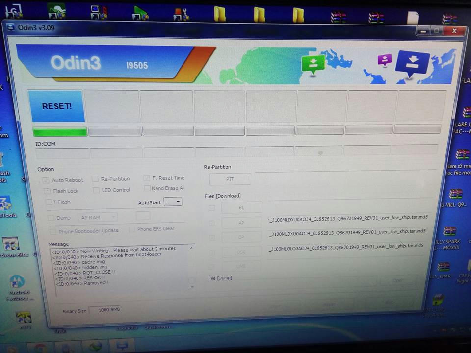

open odin tool and flash in 4 files firmware except bootloader

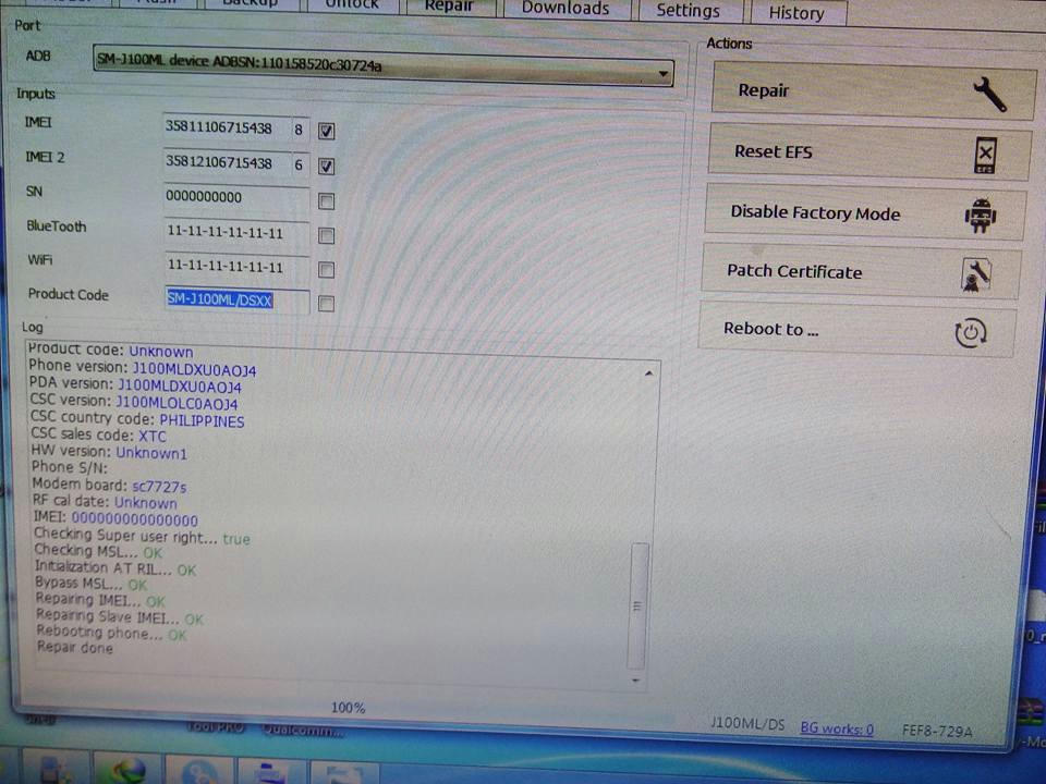

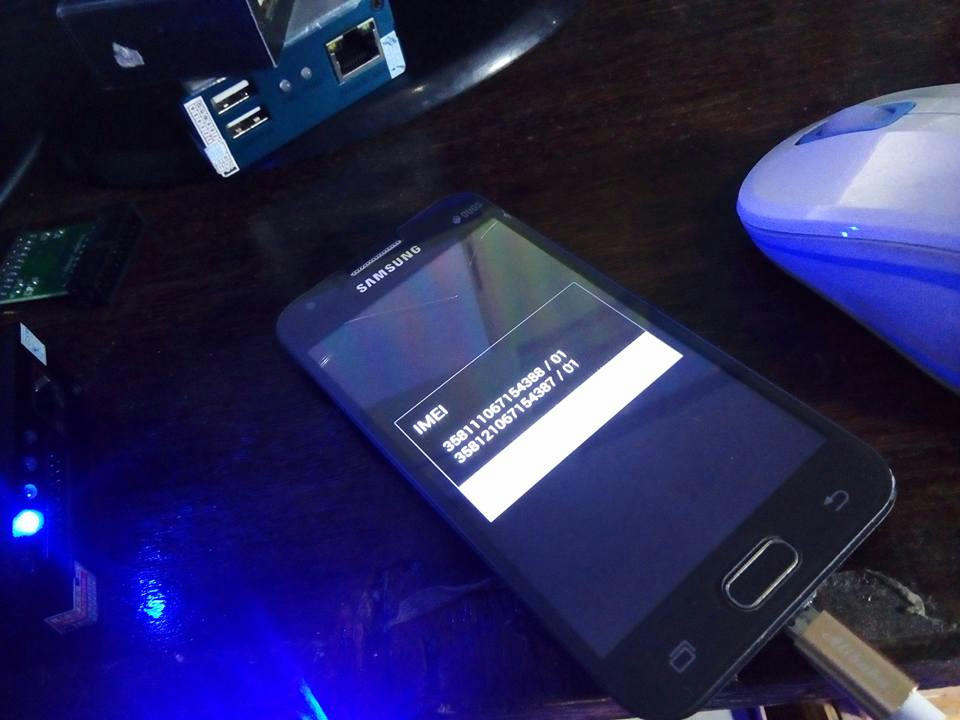

open z3x pro and repair imei

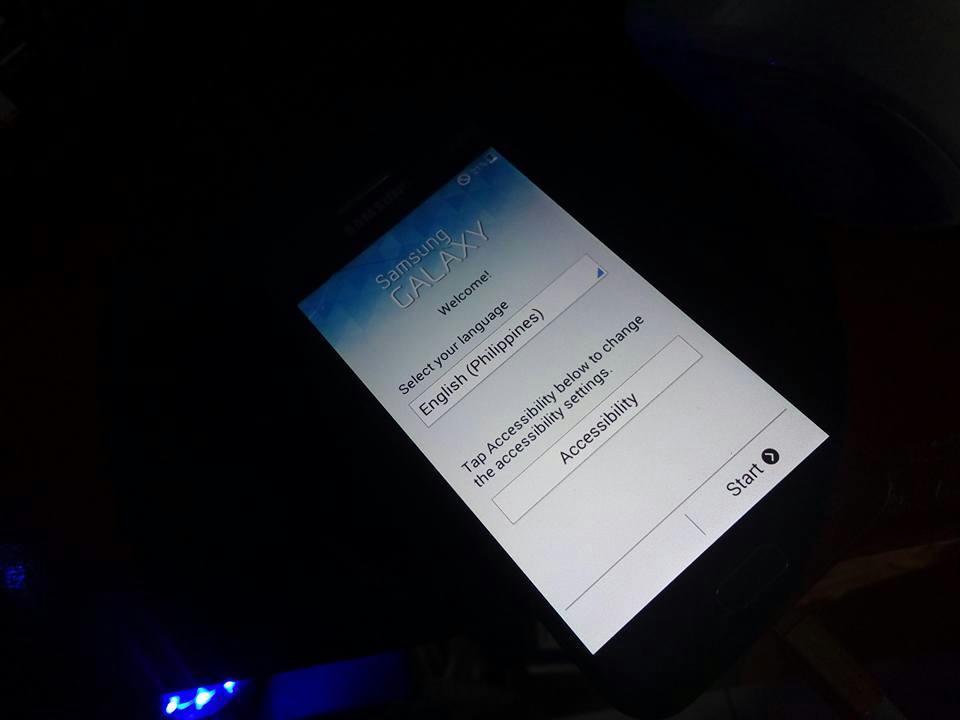

DONE!

pinout diagram
