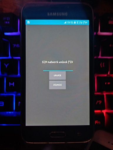

PAKITA KO LANG NA NAKA LOCK SYA

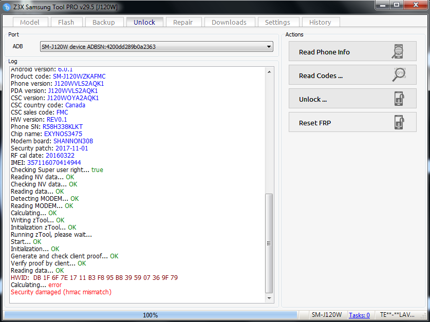

NUNG UNA UNLOCK NEW GINAGAWA KO AND READ CODE NEW
SO ETO YUNG KINAKALABASAN NYA MAY ERROR
THEN CLICK KO YUNG READ CODE LANG NAG CCLOSE KASI NGA CRACK LANG

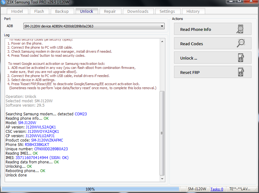

CLICK KOYUNG UNLOCK LANG
NAGULAT AKO NAG SUCCESS SO AYUN REBOOT SI PHONE AFTER REBOOT NAKITA KO NAHINGI PADIN SYA NG UNLOCK CODE
SO AGAIN SEARCH ULIT AKO. MAY NAKITA AKONG POST NA SA 28.2 DAW DOWNLOAD NAMAN AKO THEN NAKITA KO HINDI SUPPORTED NG 28.2 (CRACK) YUNG UNIT NATO.
SO I DECIDED NA ULITIN ULIT YUNG PROCESS NA UNLOCK LANG PIPINDUNTIN KO
FINALLY AYUN NAG WORK SYA.
SA KADAHILANANG DI KO ALAM PERO NAG WORK SYA.
DIKO SURE KUNG KELNGAN BA 2TIMES GAWIN PERO GUMANA SYA SO THAT'S GOOD
