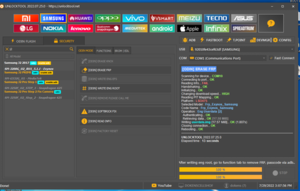

model samsung sm-j200bt
status: nakalimotan password
action: factory reset, hold vol up, home button ang power keys.. tapos wipe data.
sa frp . use unlock tool. direct lang via odine mode.. sunadan lang nasa pic
model :Samsung J2 2017
hit [ODIN] ERASE FRP
info :
thanks for viewing..
info :
[ODIN] ERASE FRP Scanning for device... COM17
Connecting to port... OK
Reading Info... FAIL
Handshaking... OK
Initializing... OK
Changing download speed... HIGH
Reading PIT Mapping... OK
Platform : LSI3475
Selected Model : Frp_Exynos_Samsung
Code Name : Frp_Exynos_Samsung
Operation : Eng Userdata [2]
Authenticating... OK
Retrieving data... OK [17.58 MiB]
Writing userdata.img [17.57 MiB]... OK (1.396s)
Closing connection... OK
Rebooting... OK
UNLOCKTOOL 2022.06.29.0
Elapsed time : 1 minute 15 seconds
