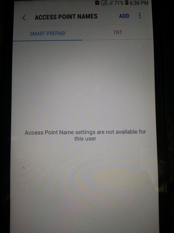

share ko lang boss j260y globe lock siguro at naipaopenline n s iba
di lang gumgna ang data nya s Smart o TNT at ndi rin pwd mag-add ng APN

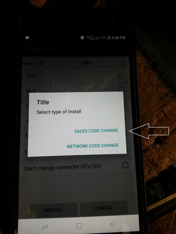

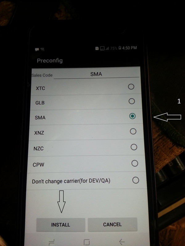

1. enable nyo po ung oem pti usb debugging
2. kopyahin nyo muna khit s notepad dial *#06#
3. tpos dial *#272*IMEI#
tpos e2 llbas
pnili ko ung SMA ksi smart ggmitin n sim tpos install
tpos piliin lng change sales code
maeerase po ung userdata nya prang ngformat
kya po kailangan enable oem pra ndi mgkaproblema

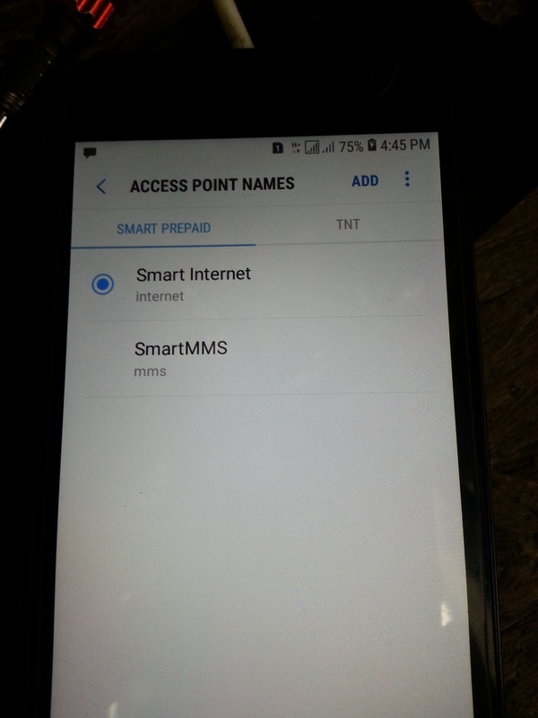

yan po automatic n may APN nya sna makatulong po s inyo
note: ung nsa pic po SMA n ung sales code ksi nung GLB p xa ndi ko
napicturan... inulit ko n lng pra gwing procedure
