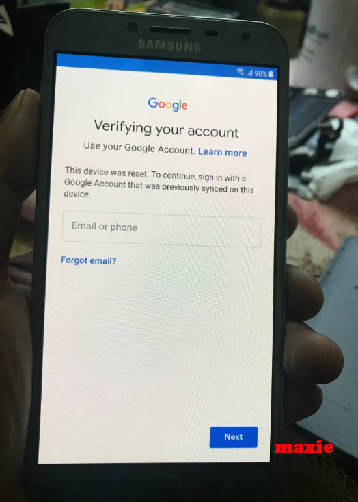

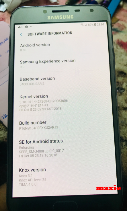

Hi

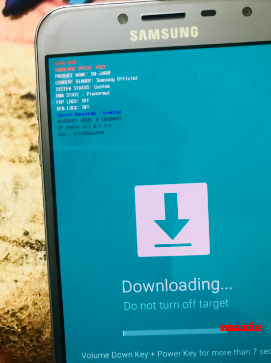

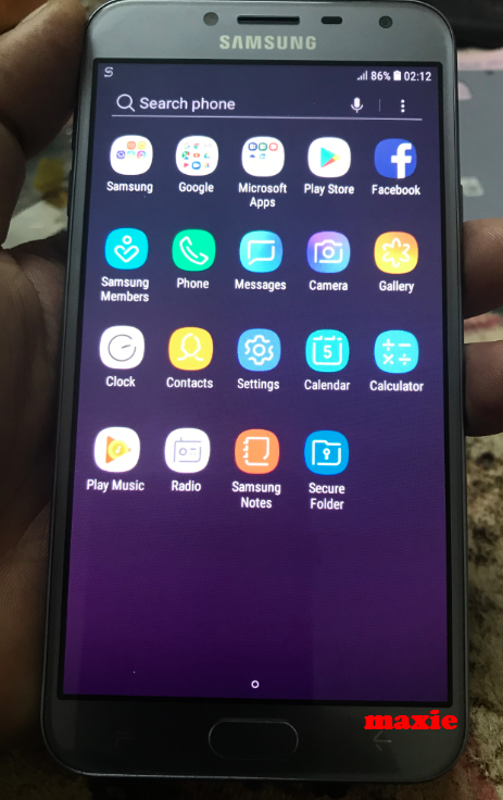

Unit: Samsung
Model: SM-J400f-DS
Firmware:J400FXXU2XXX

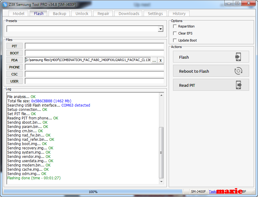

Solution: Bypass using combination file
Procedure:
  • Download Combination File
  • Flash using Z3x

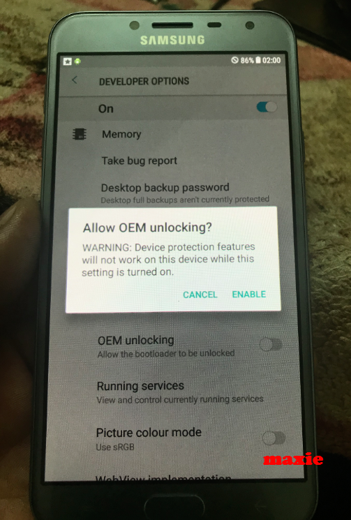

  • Open Setting
  • Enable Developer Mode
  • Enable OEM Unlocking

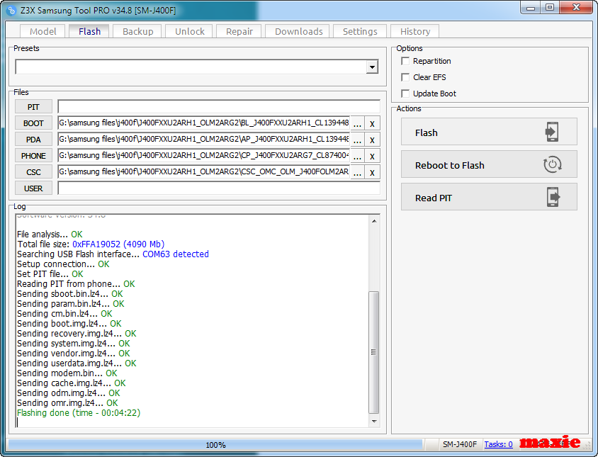

  • Flash latest Frimware or the same boot U2
  • Done

Logs
Code:
Operation: Flash
Selected model: SM-J400F
Software version: 34.8
File analysis... OK
Total file size: 0x5B6C8B88 (1462 Mb)
Searching USB Flash interface... COM63 detected
Setup connection... OK
Set PIT file... OK
Reading PIT from phone... OK
Sending sboot.bin... OK
Sending param.bin... OK
Sending cm.bin... OK
Sending nad_fw.bin... OK
Sending nad_refer.bin... OK
Sending boot.img... OK
Sending recovery.img... OK
Sending system.img... OK
Sending vendor.img... OK
Sending userdata.img... OK
Sending modem.bin... OK
Sending cache.img... OK
Sending odm.img... OK
Flashing done (time - 00:01:27)
Done with Samsung Tool PRO v.34.8
Logs
Code:
Operation: Flash
File analysis... OK
Total file size: 0xFFA19052 (4090 Mb)
Set PIT file... OK
Sending sboot.bin.lz4... OK
Sending param.bin.lz4... OK
Sending cm.bin.lz4... OK
Sending boot.img.lz4... OK
Sending recovery.img.lz4... OK
Sending system.img.lz4... OK
Sending vendor.img.lz4... OK
Sending userdata.img.lz4... OK
Sending cache.img.lz4... OK
Sending odm.img.lz4... OK
Sending omr.img.lz4... OK
Flashing done (time - 00:04:22)
Finish

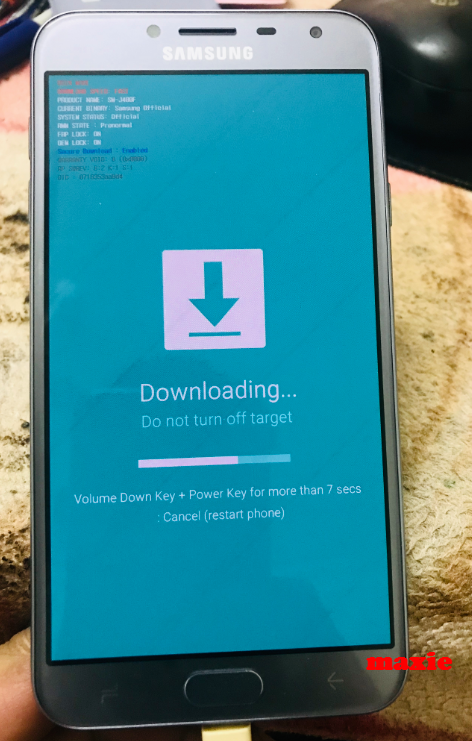

Kung napansin nyo meron kulay pula sa U2? ibig sabihin yong ho yong boot version ng Unit:D
Offcource meron pong susi yan link paano ma buksan? hmmm alam nyo na gagawin TATSULOK
