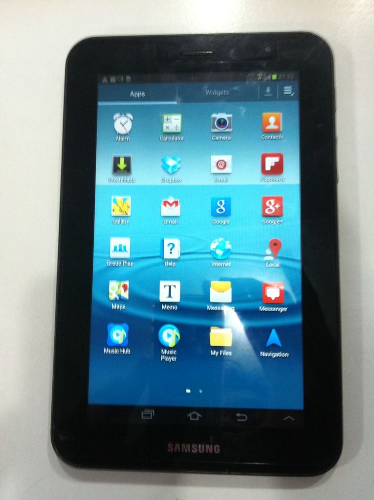

samsung tab 7.0 hang on logo only
[URL=http://s1062.photobucket.com/user/jony257/media/IMG_0911_zpsrtdi1poe.jpg.html]
[/URL]

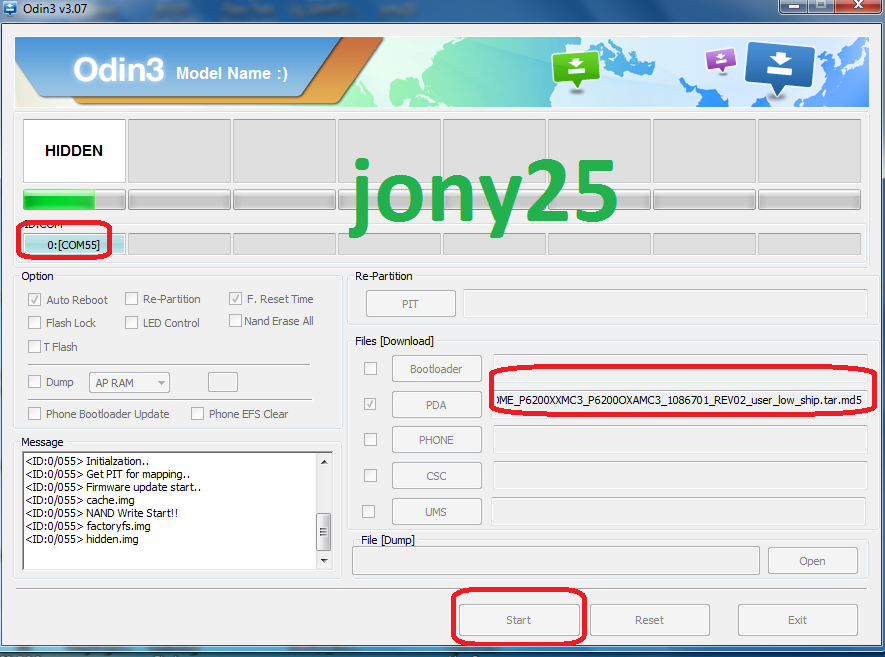

procedure
1.download firmware and odin
2.extract the file
3.open odin put into PDA extract file
4.hol vol down to download mode.
5.plugin usb cable to the tab..
6.click start..
7.waiting for finish flashing
8.done..

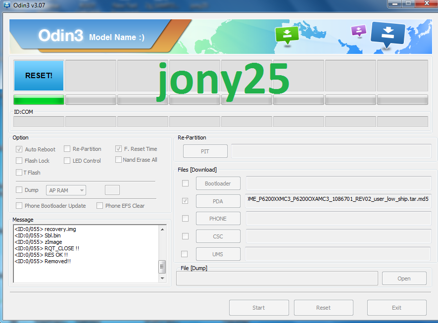

[URL=http://s1062.photobucket.com/user/jony257/media/tab%201_zpsyl7rxlb4.png.html]
[/URL]
[URL=http://s1062.photobucket.com/user/jony257/media/tab%202_zpsllrlnia1.png.html]
[/URL]
finish

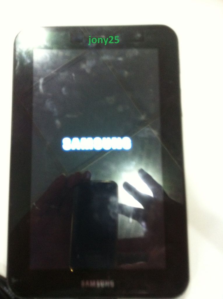

[URL=http://s1062.photobucket.com/user/jony257/media/IMG_0913_zpsmufv6xot.jpg.html]
[/URL]
