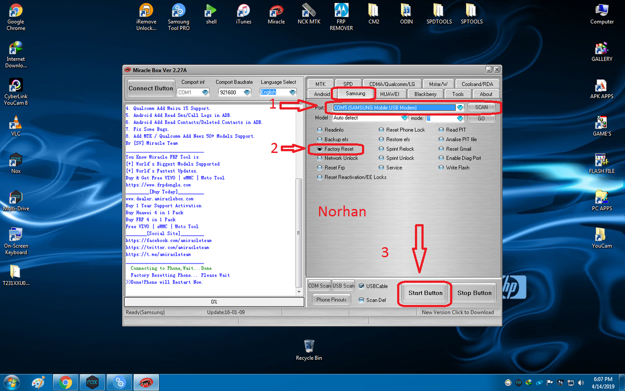

Share ko lang tanggap ko

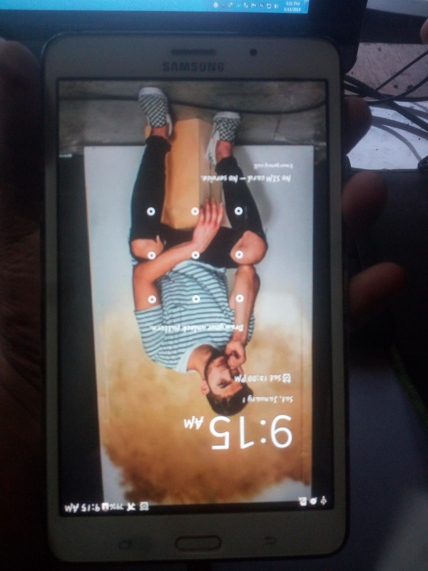

Unit : SM-T230
Status : Pattern
History : di magkuha home botton nya kya d ma hard reset
Procedure : Factory Reset By Miracle Crack 2.27
1. Power on Phone in Normal mode
2. Open miracle crack 2.27
3. Connect USB cable To Phone
4. Factory reset and click Start Botton
At hintayin matapos
Screen Shots

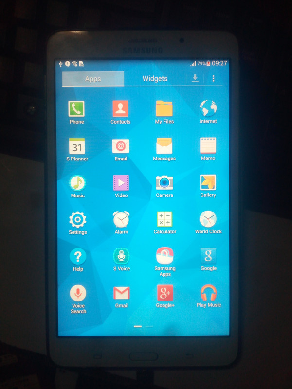

Slamat sana maka Tulong
