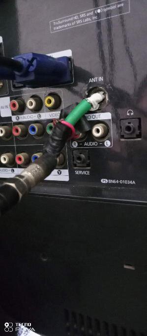

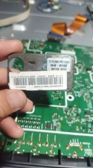

technician reinstall the tuner in doing a shortcut way but the problem is possible grounding or not quality image.

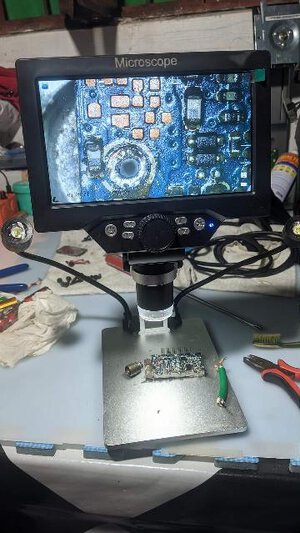

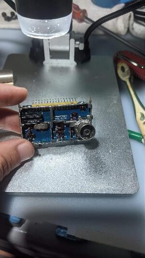

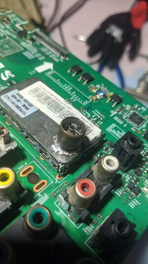

Ginawa ko as you can see in the picture nilagyan lang ng wire working but not quality image .. putol yung bakal di nya siguro binigyan ng effort paano ikabit.

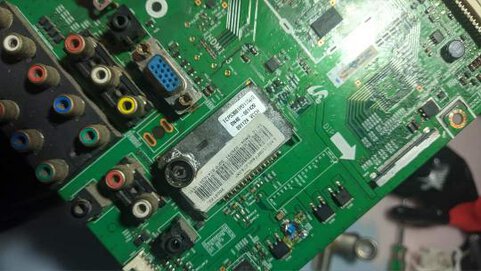

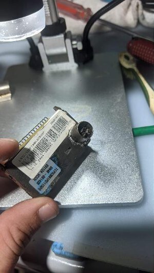

So binaklas ko yung tuner sa board and Dahan Dahan ko tinanggal lahat ng wire at ikabit sa original form ng tuner yung bakal Pati grounding at positive nya pwede nyo lagyan ng dugtong Kung sakaling yung positive is di na maabot yung board.. then after makabit lahat soldering lead lang ang katapat ng pagdikit ulit sa metal frame dapat is makapit yung lead at marami para iwas tanggal .
Maganda yung malinis tingnan yung board at tv kaysa lagyan ng lawit na wire possible pa mag cause ng sira sa board.. lahat is makukuha sa tyaga di sa mabilisang repair for money..

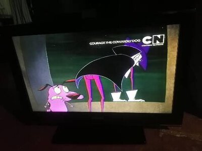

Results will amaze you joke malinaw na sya
