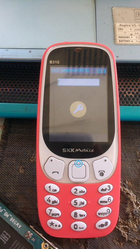

SKK B310 password done cm2 SCR

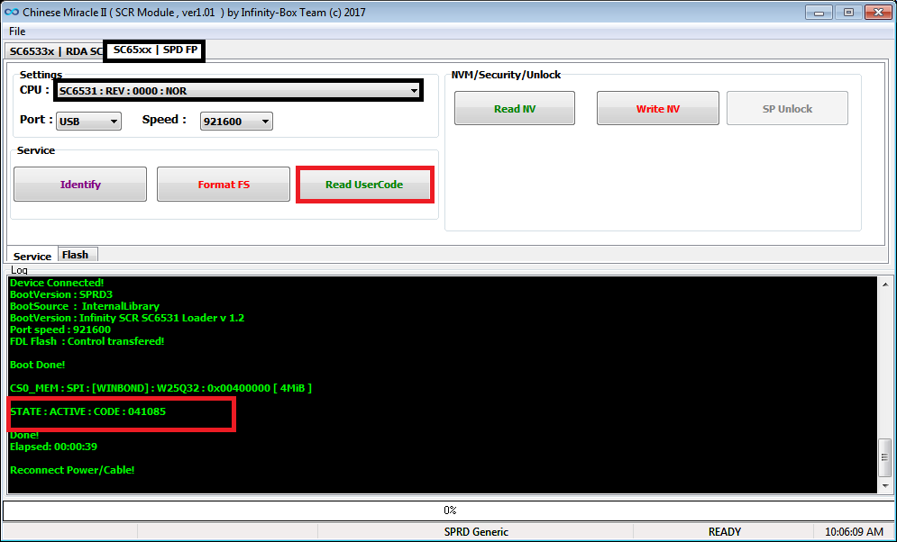

procedure:
open cm2 scr
click sc65xx spd fp
cpu sc6531 :rv:0000:nor
read user code
saksak usb hold voll up nasa picture boot key :D
log's
Code:
Card found : 6CB042B6 , v0136
Infinity-Box Chinese Miracle II : SC/RDA Module [SCR] v1.01
SCRD mode : AUTO
SPRD mode : SC6530 : REV : 0000 : NOR
SPRD mode : SC6531 : REV : E000 : NOR
Operation : Format FileSystem [ v1.01 ]
1. Power off device
2. Press and hold BootKey or use BootCable
3. Insert cable and battery in device!
Wait for device ...
Device Connected!
BootVersion : SPRD3
BootSource  :  InternalLibrary
ERROR : FDL NOT started!
Error : Loader send failed!
Wrong model selected! Select correct one!
Reconnect Power/Cable!
SPRD mode : SC6531 : REV : 0000 : NOR
Operation : Read UserCode [ v1.01 ]
1. Power off device
Wait for device ...
Device Connected!
BootVersion : SPRD3
BootVersion : Infinity SCR SC6531 Loader v 1.2
Port speed : 921600
FDL Flash  : Control transfered!
Boot Done!
Error : PMT info not found! Damaged device MCU code!
Send log and report.log to support! Include device info also!
1. Power off device
Wait for device ...
Device Connected!
BootVersion : SPRD3
Port speed : 921600
Boot Done!
CS0_MEM : SPI : [WINBOND] : W25Q32 : 0x00400000 [ 4MiB ]
STATE : ACTIVE : CODE : 041085
Done!
Elapsed: 00:00:39

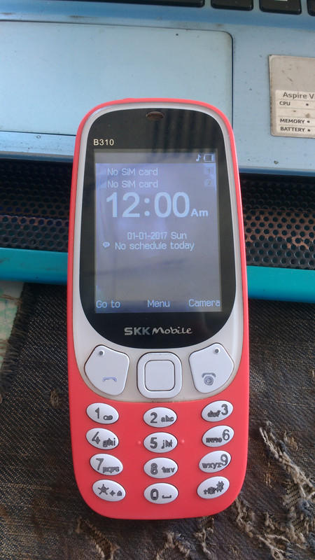

Done :D
reset u na lang pag katapos mga boss sana maka tulong
