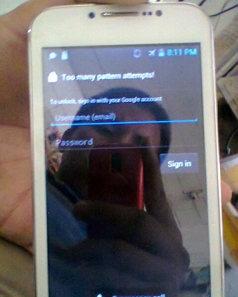

Bwena manu ko naman kanina mga Boss share ko lang SKK EVOLVE
Problem ;Too many pattern.

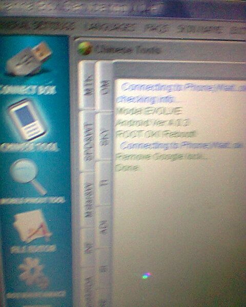

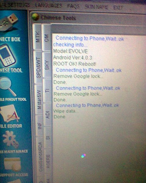

open piranha sofware,select android tool
Press select ADB (ROOT)then salpak usb sa phone
tapos select remove google lock pero ganun parin
kaya decide nalang ako select WIPE, buti nakuha din
hantayin mag restart unit tapos ok na..remove done .
