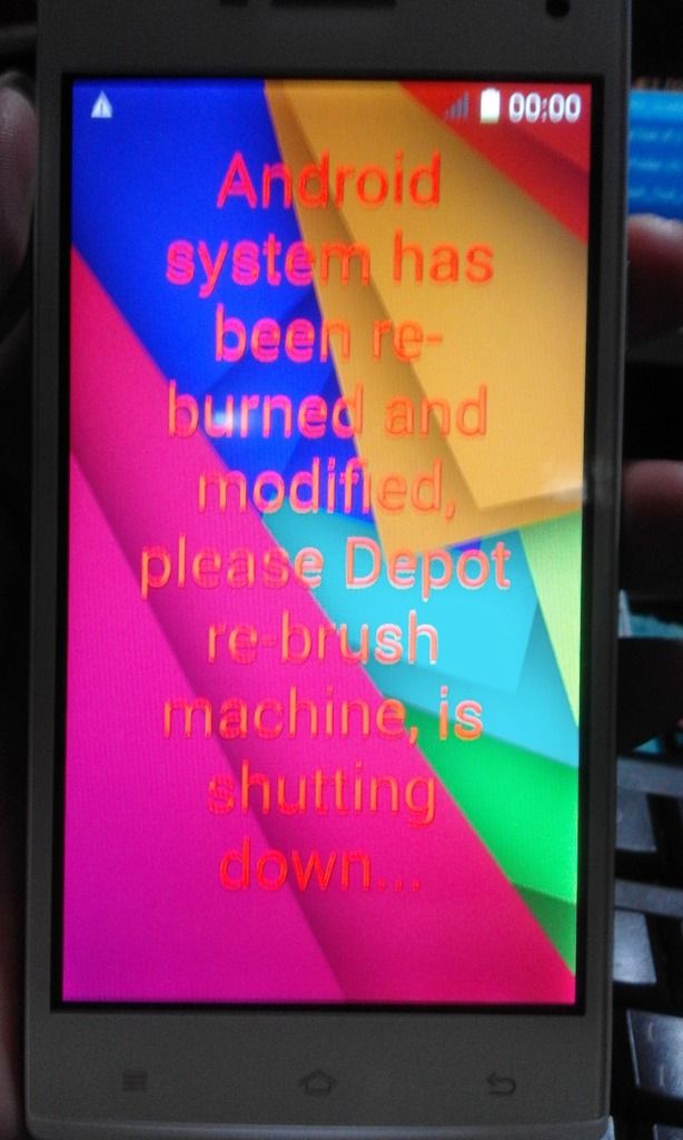

Good day mga sir share ko lang po as refference itong skk prime plus with mt6571 chips with version YK858_GUANGWEI_SKK_PRIME_EN_GPS_6571_EMMC1_141121_2014 problem po nito may lumalabas sa screen na ANDRIOD HAS BEEN REBURNED OR MODIFIED PLEASE DEPOT REBRUSH MACHINE IS SHUTTING DOWN AND REBOOT
HISTORY NG PHONE SINALPAKAN LANG DAW NG MMC NA MAY UPDATE ZIP NG SAMSUNG MODEL PAG REBOOT NG UNIT NYA NAGKA GANUN NA

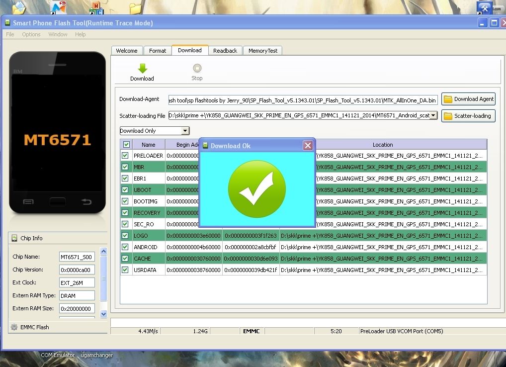

kaya proceed na ako sa flashing
hers some of my screenshots

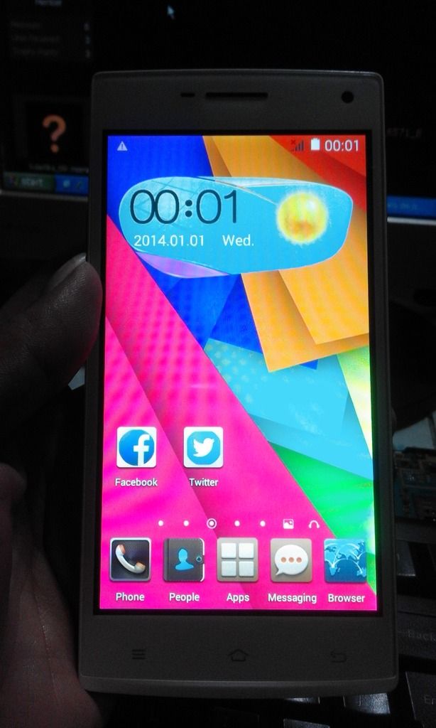

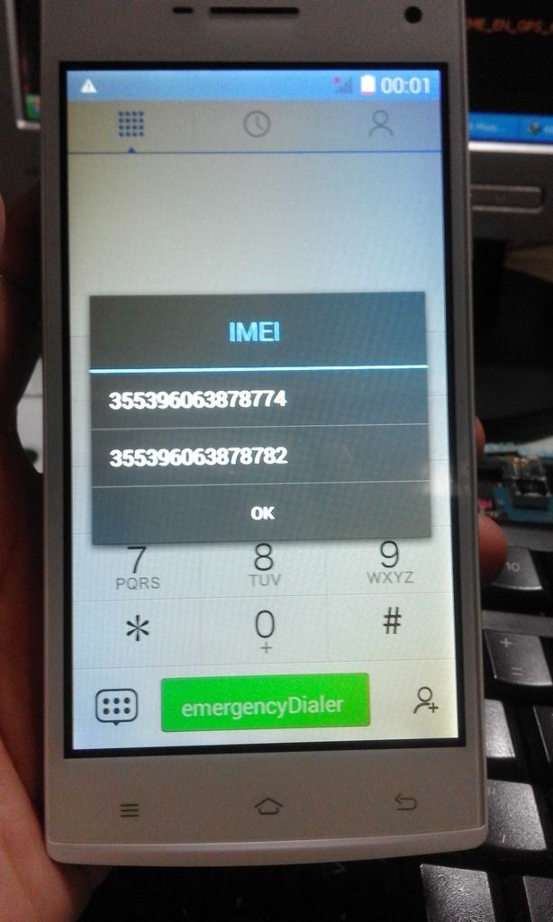

after flash check ko imei ayos

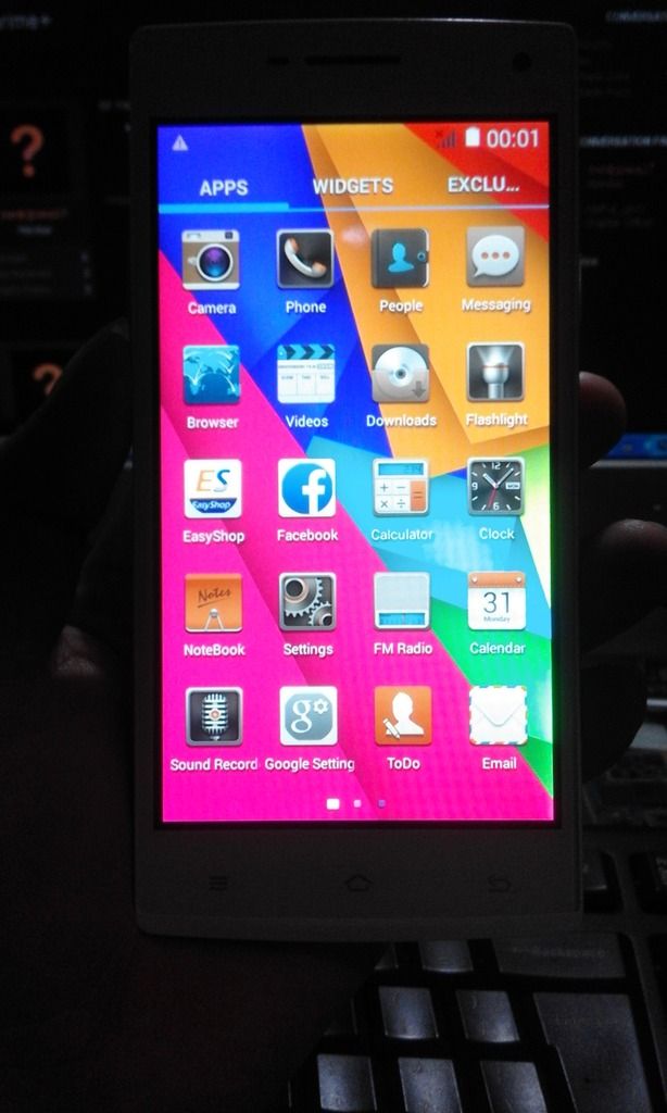

finish product
