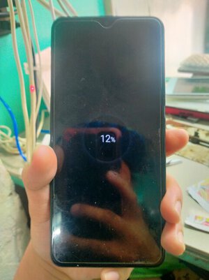

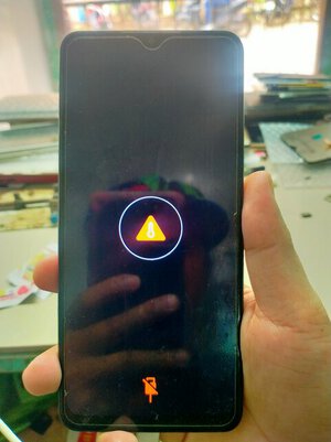

history : nabasa daw sabi ni tumer, ayaw na mag charge temp error pag salpak ng charger
action taken
1st baklas model check mobo and charging bord, goods naman walang bakas ng basa
2nd linis charging board , no luck
3rd change charging pin no luck
4th hanap hanap sa google at youtube

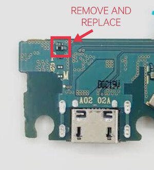

my nakita ako ne resold lang yung caps, pero yun akin pinalitan ko dalawa maliit at malaki na caps nasa baba yung pics kun san banda yung caps mag katabi lang maliit at malaki,
at sa samsung na board ako kumuha ng caps pamalit, make sure na pareho yung pamalit.
action taken
