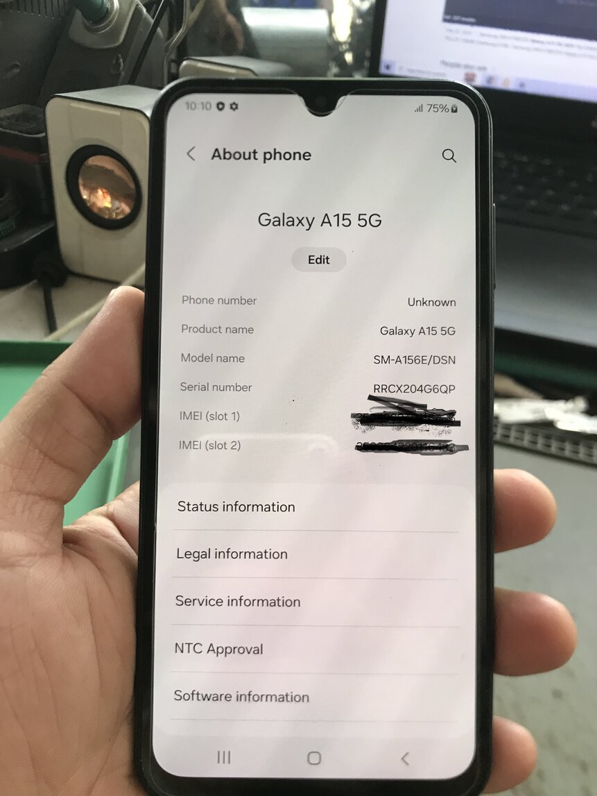

unit info :
Model Info: MOBILE SM-A156E/DSN BLACK PHL
Search Term:
IMEI 1:
Serial Number: RRCX204G6QP
Model Desc: Galaxy A15 5G
Model Name: SM-A156E/DSN
Model Number: SM-A156EZKDPHL
Warranty Status: Warranty Active
Estimated Warranty End Date:
Production location: China SEHZ
Production Date:
Country: Philippines
Carrier: Factory Unlocked

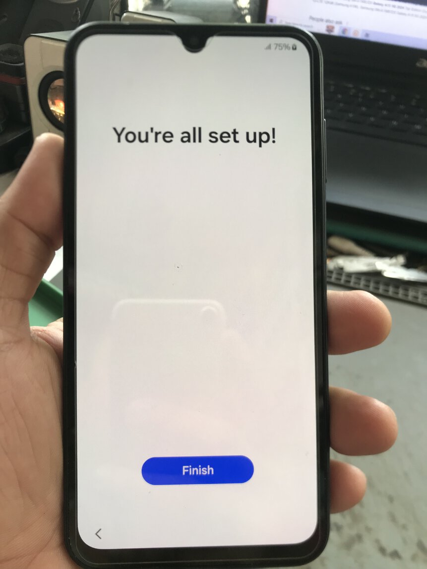

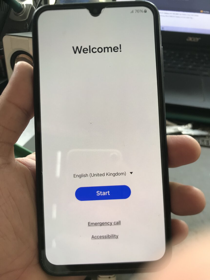

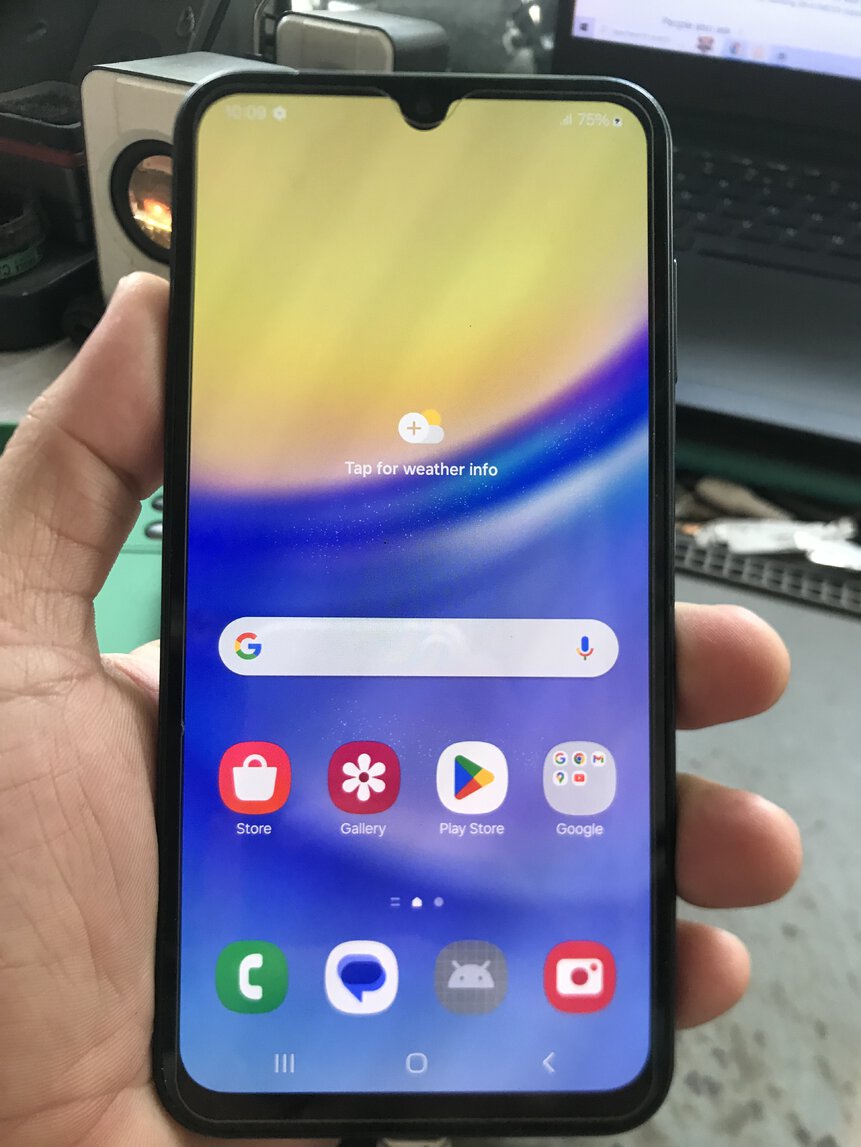

password procedure:
na sa video how to reset

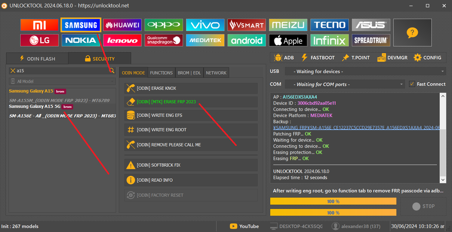

frp procedure:
- *#0*# not working
- ganito ginawa ko
dahil soport sia ng ut tool
- download https://unlocktool.net/
- go to samsung tab
- search A15 5g
- off unit hold voll up / down para mag down load mode saksak usb pag labas ng download mode press voll up
- click [ ODIN ] [ MTK ] ERASE FRP 2023
picture :
frp info :
[ODIN] [MTK] ERASE FRP 2023 Scanning port... OK
Reading Info... OK
Model : SM-A156E
Storage Capacity : 128G
Manufacturer : SAMSUNG
Firmware Version : 0003
CSC : XTC
AP : A156EDXS1AXA4
Device ID : 3006cbd92aa05e11
Connecting to device... OK
Device Platform : MEDIATEK
Backup : \SAMSUNG_FRP\SM-A156E_CE12237C5CCD29E7357E_A156EDXS1AXA4_2024-06-30_10-10-11
Patching FRP... OK
Waiting for device... OK
Erasing protection... OK
Erasing FRP... OK
UNLOCKTOOL 2024.06.18.0
Elapsed time : 12 seconds
