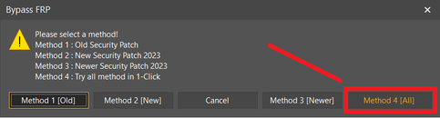

sa frp naman
open UNLOCK TOOL
click samsung
functions [com] remove frp 2023 click
click 4method [all] saksak unit lalabas allw click mo antayin mo lang mag done

sa frp naman
open UNLOCK TOOL
click samsung
[COM] REMOVE FRP [2023] Scanning for device... COM40
Reading Info... FAIL
Trying method [1]... FAIL
Trying method [2]... OK
Waiting for device...
Model : SM-A715W
Manufacturer : samsung
Platform : sm6150
CPU Arch : arm64-v8a
Android Serial : R58NC027J1H
Manufacturing Date : 2020.12.01
Security Patch : 2023-05-01
Connection : mtp,adb
Timezone : Asia/Manila
Android Version : 13
Android SDK : 33
Build : TP1A.220624.014.A715WVLS5EWD2
Build Date : Tue Apr 25 13:54:00 KST 2023
Product Code : SM-A715WZKAXAC
Device Name : a71
Product Name : a71cs
Code Name : SM-A715WZKAXAC
BL : A715WVLS5EWD2
PDA : A715WVLS5EWD2
CP : A715WVLS5EWD2
CSC : A715WOYV5EWD2
Sales Code : XAC
Removing FRP... OK
UNLOCKTOOL 2023.07.12.0
Elapsed time : 28 seconds
