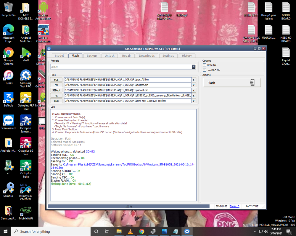

open z3x
dl flashfile from support (B105EJPUAQF1_OJPAQF1)
extract then load all fw needed
flash
phone with out battery (no battery while flashing)
hold center button then connect micro usb
wait flashing until completed
power on phone
insert any sim
done
sobrang kunat ng sim lock
kahit reset andun pa din
unlock na andon pa din
reset format sa nck box spd,andon pa din simlock
final solution flashing tru z3x box tested
sana makatulong..
