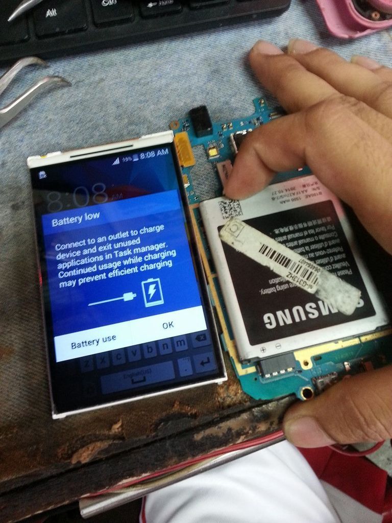

Problem
No display na after mabagsak
Action Taken
Test w/ good Lcd but no display parin

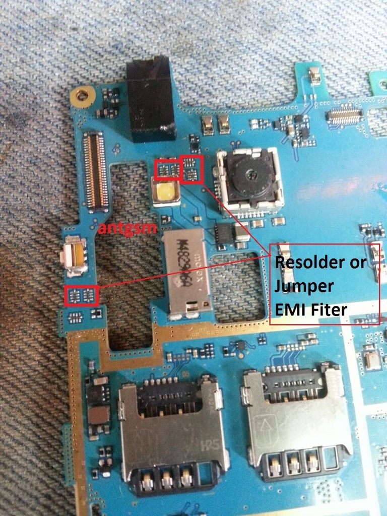

try ko jumper EMI Filters but same status no display

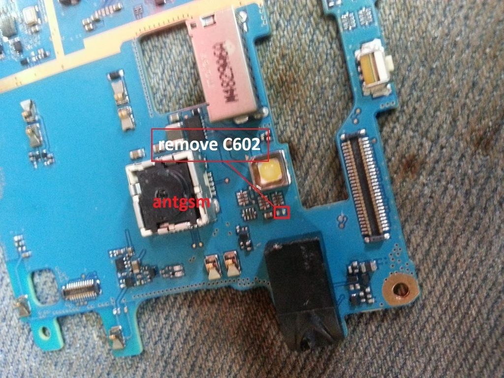

so check ko these two capacitor connected to display
C602 = 2.8v
C604 = 1.8v
at boomm..! si C602 pala ung salarin 1.3v
na dapat ay 2.8v then try ko muna remove
sabay testing akalain mo nag display
Done...!!
