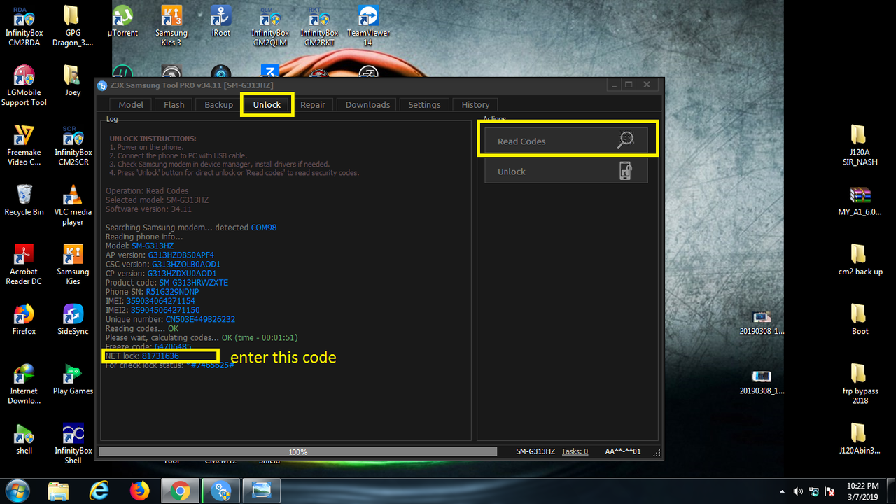

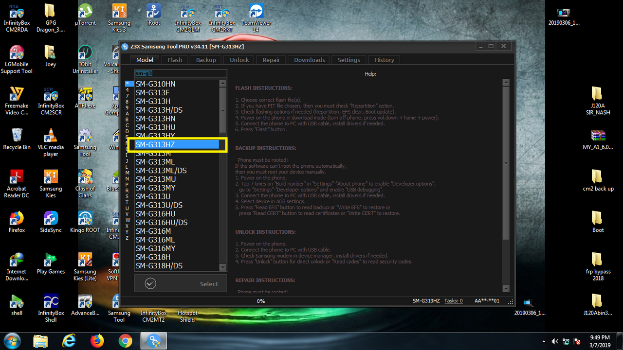

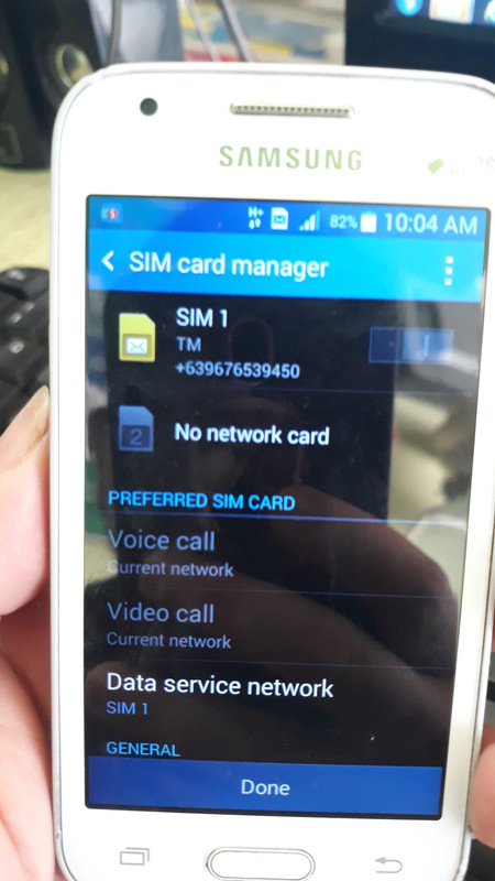

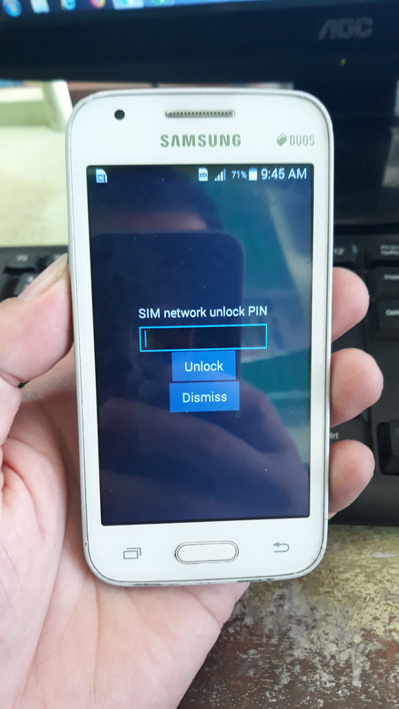

share ko lang samsung galaxy v lock sa sun unlock done sa z3x tool pro via read codes..
action taken
turn on developer options by pressing build number 3 times
go to developer options
check usb debugging
open z3x tool pro
select model
select unlock
insert usb cable
and hit read codes
pics...
done...
