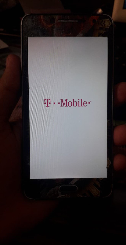

SM-G530T T MOBILE FRP DONE Z3X PRO
history nireset ni tomer
galing na sa kapitbahay
di kinaya ng bypass at magic hands
solution z3x pro
reset frp pero error di madetect adb
need para maenable adb
et download muna

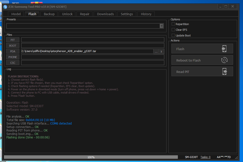

http://www.mediafire.com/file/mgqzqgwqt7ud9ug/atorpherson_bypass_frp.rar/file
eto para mag boot sa adb
flash sa z3x pro
put in pda
then put phone in download mode
tick flash

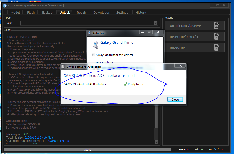

after flash magrerestart
wag na bunutin wait mag install driver adb

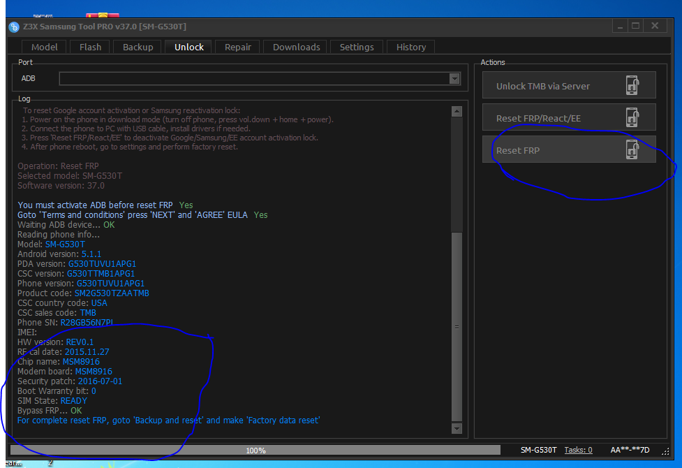

ayan proceed na sa reset frp

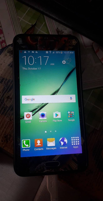

diretso na sa home screen yan
punta nalang setting tapos reset manually
done finish na

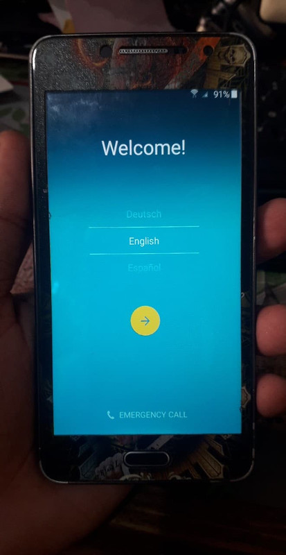

done finish na
