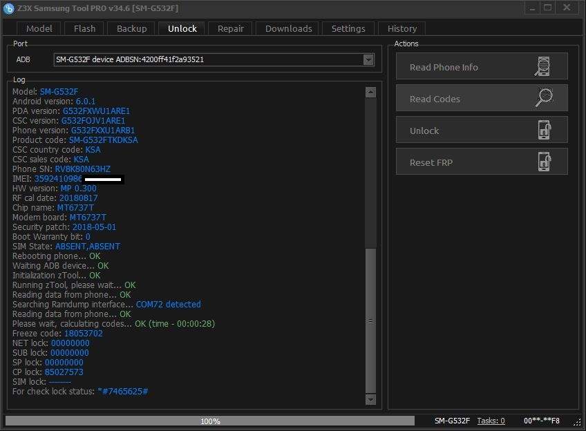

. Open USB Debug in settings
. Dial *#0808# tapos piliin si DM+ACM+ADB
then press ok
. Then hit read codes only not direct unlock kasi
medyo risky at need pa iroot kaya read codes lang
. no need root na po sa latest z3x samsung tool pro
DONE
