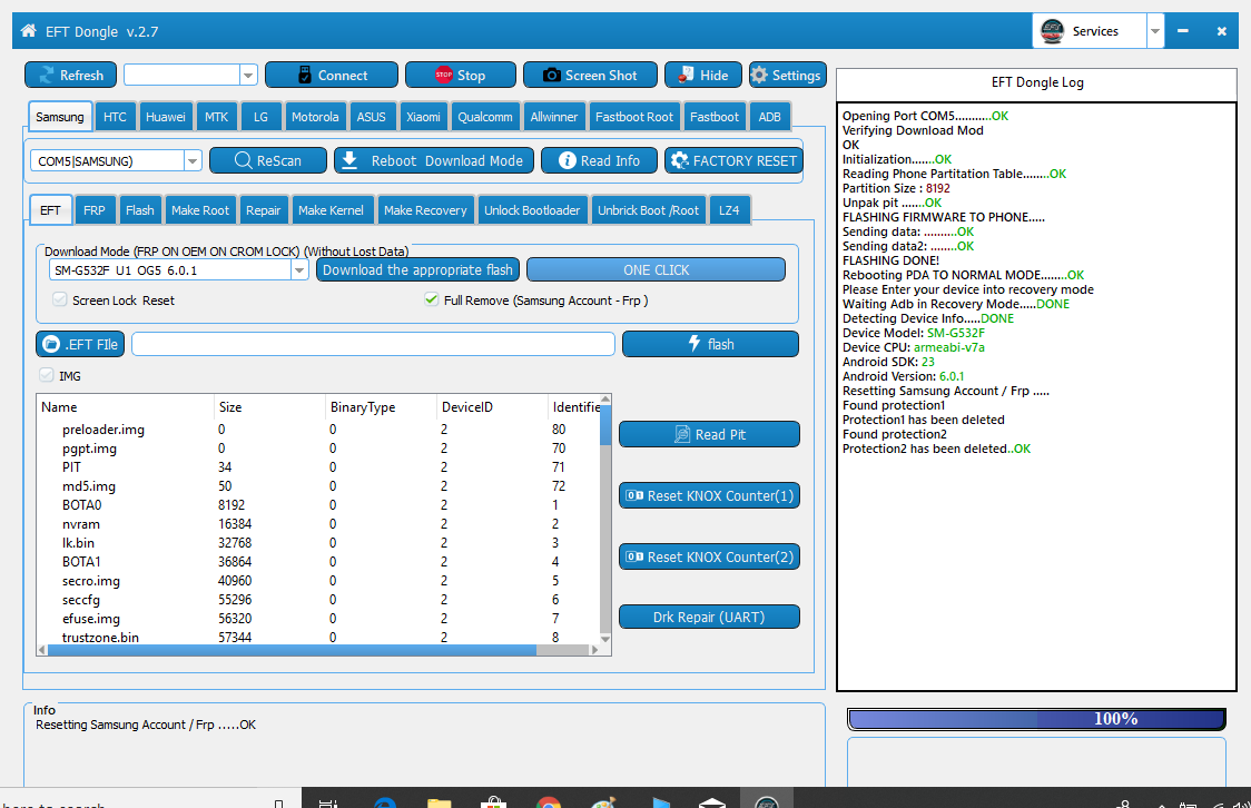

Run eft dongle
Select model sm-g532f u1 og5 6.0.1
Put phone in download mode – connect to pc
Press rescan to check if phone connects
Press one click – program starts – just follow the instruction –
After done phone will reboot – it show password require to enter.

Run eft dongle
