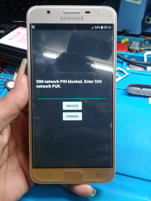

SM-G610F SAUDI LOCK DONE
HISTORY
DI MAGAMIT NI TUMER NG SIM DITO
SO ALAM NA NATIN DAPAT NA GAWIN

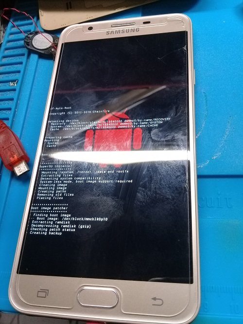

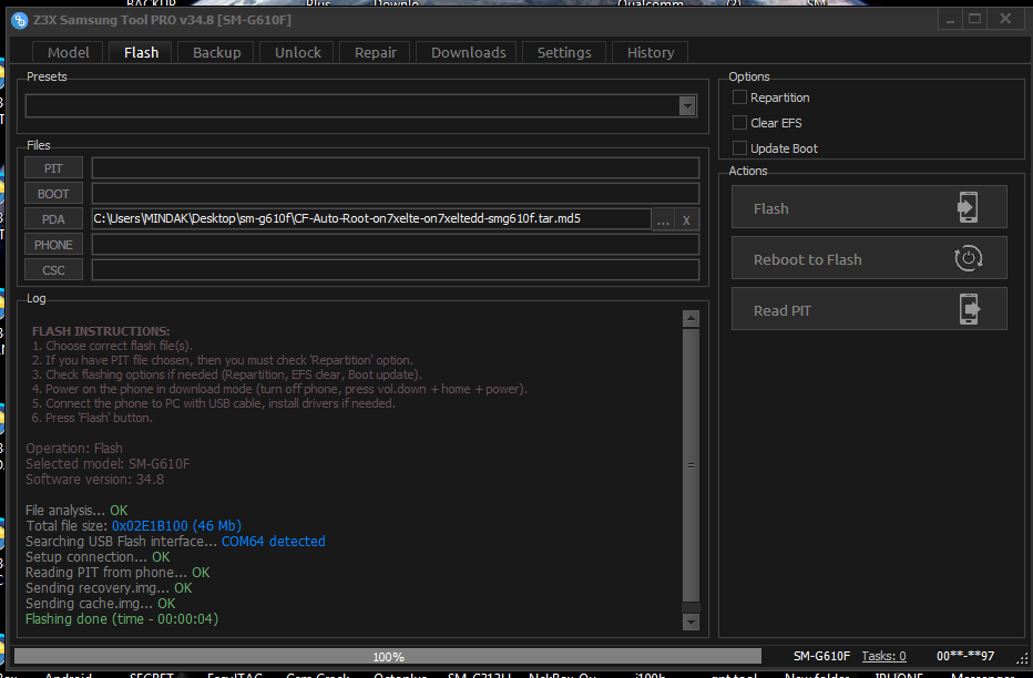

SO DL ROOT FILE
https://download.chainfire.eu/1036/CF-Root/CF-Auto-Root/CF-Auto-Root-on7xelte-on7xeltedd-smg610f.zip
NOTE FLASH 2 TIMES ANG ROOTFILE
KC MNG,HINGI NG RESET UNG UNANG ROOT
AFTER NG 2ND ROOT

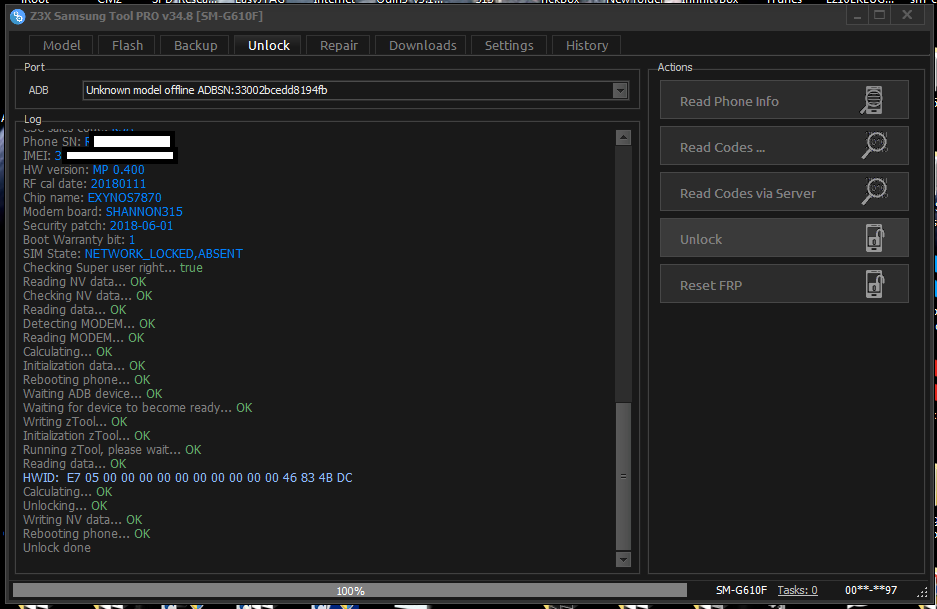

HIT DIRECT UNLOCK NA

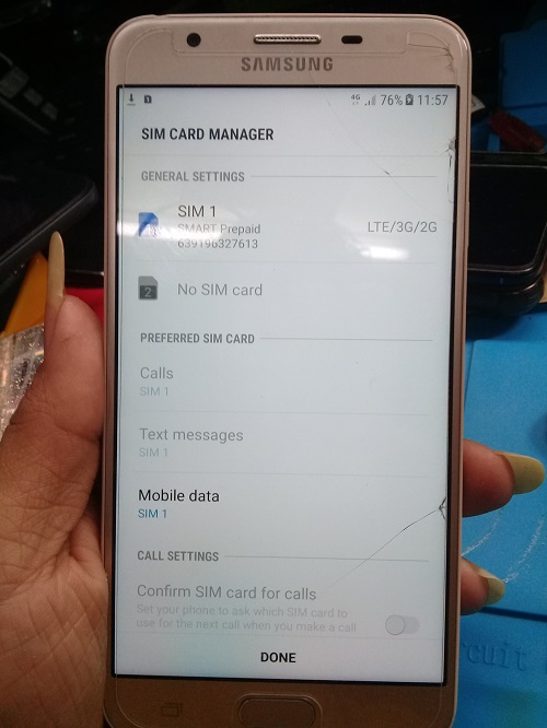

DONE NA HAPPY NA SI TUMER
