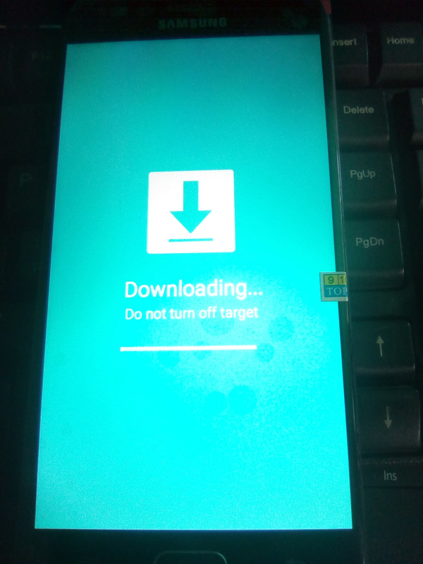

dala ni tumer,, hang lng sya,, try sa hard reset at hijacker softbreak ayaw din,,,, hanap ng sulusyon,,,,,
https://updato.com/firmware-archive-select-model?record=1199CA7452AC11E7963AFA163EE8F90B
firmware...

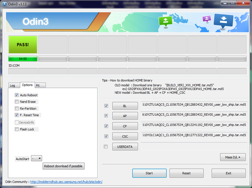

instruction,,,Extract (unzip) the firmware file
2
Download Odin Tool 3.13.1
3
Extract Odin ZIP file
4
Open Odin 3.12.7
5
Reboot Phone in Download Mode (press and hold Home + Power + Volume Down buttons)
6
Connect phone and wait until you get a blue sign in Odin
7
Add the firmware file to AP / PDA
8
Make sure re-partition is NOT ticked
9
Click the start button, sit back and wait few minutes

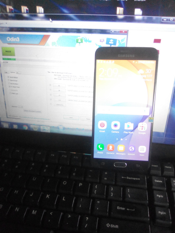

sana makatulong yan,, salamat,,,
