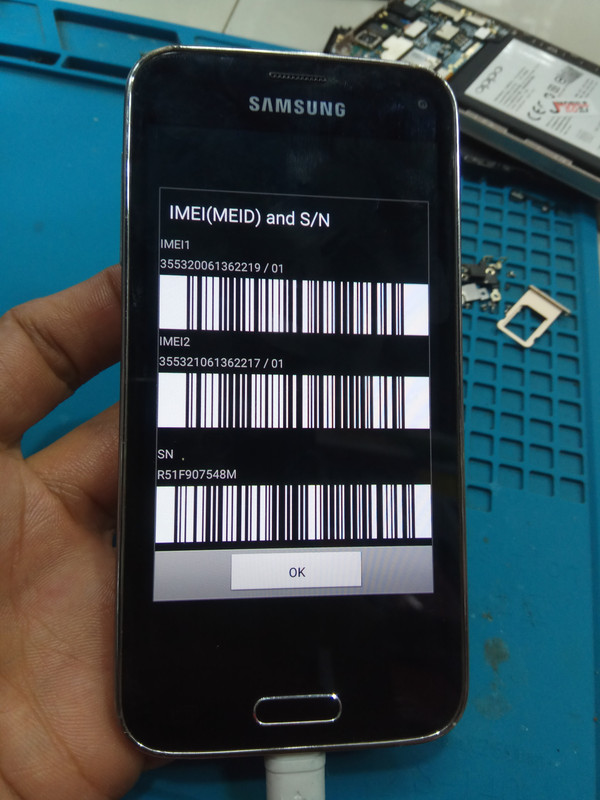

REFERENCE SM-G800H 6.0.1 invalid sim downgrade modem then unlock tested

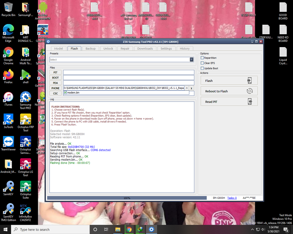

flashing phone with modem only

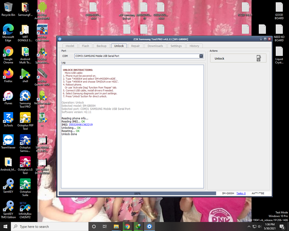

after flashing,do unlock
done..
ito yung fw na ginamit ko para ma downgrade ang modem
sm-g800h 5.1.1 for dg modem

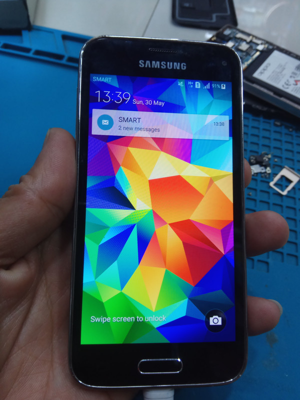

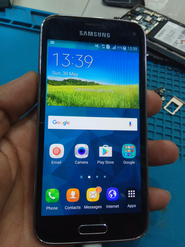

ito na finish product
