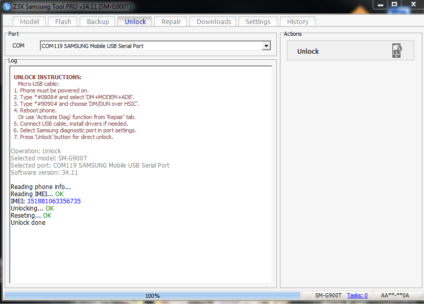

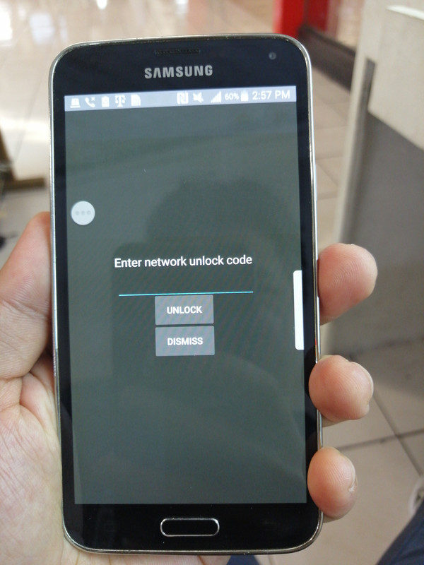

* tanggap q mga boss samsung SM-G900T T-Mobile

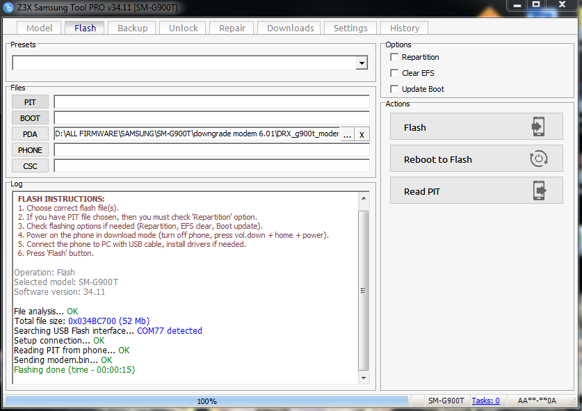

* kaya proceed nq sa z3x kaso pag unlock q error
* need pa downgrade ung modem
* eto poh ginamit qng modem https://www.4shared.com/file/Od5lyPu1ei/DRX_g900t_modem511tar.html

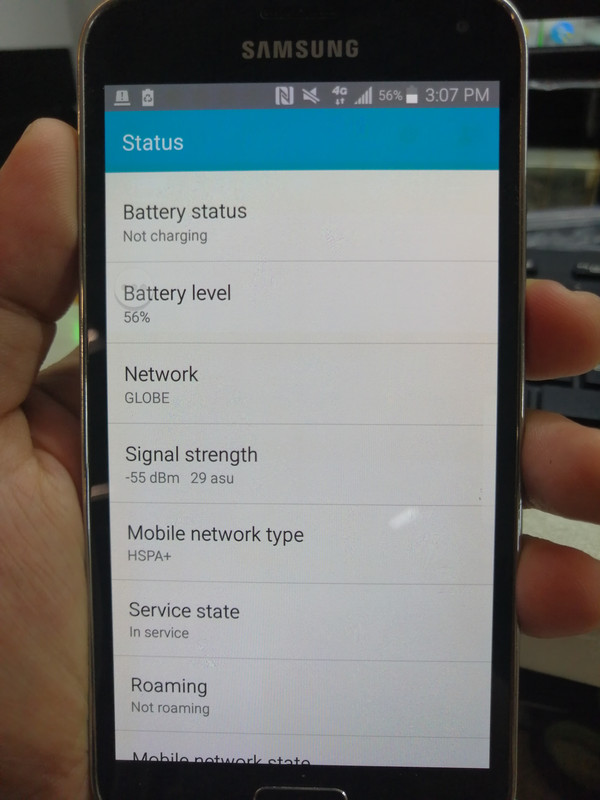

* unlock done
