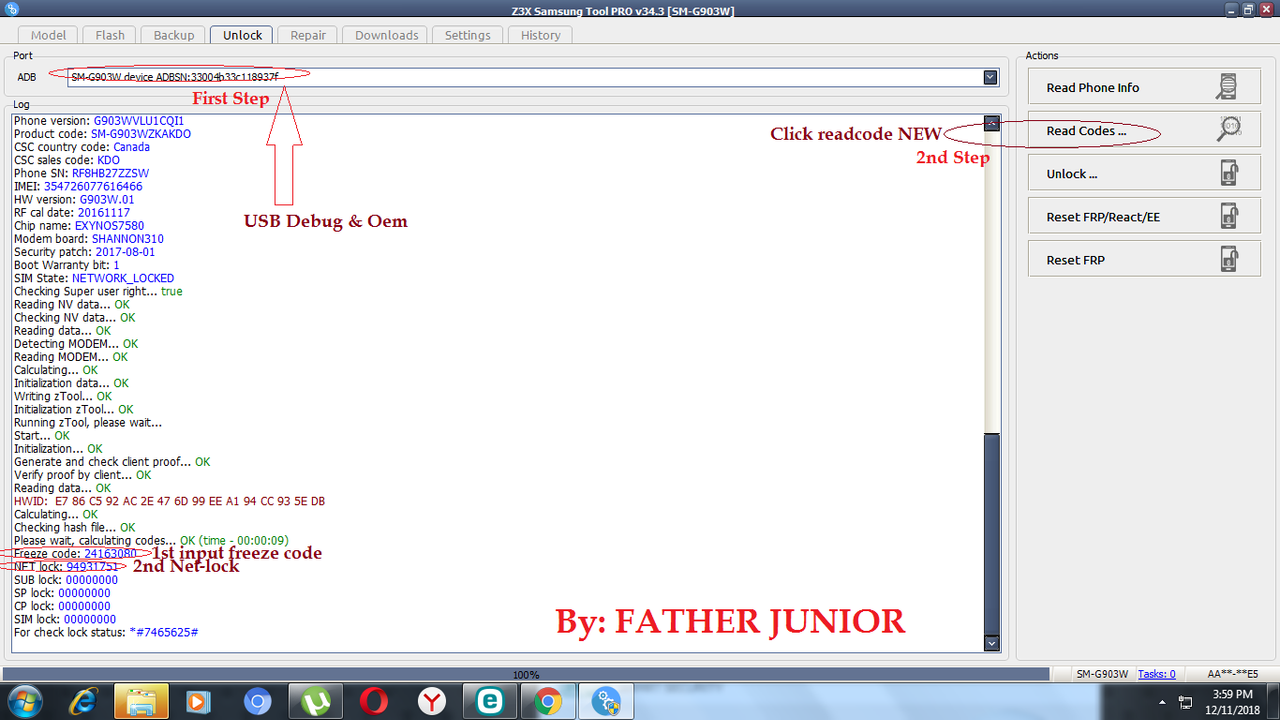

Share kolang po SM-G903W problem unlock nid root files
Slamat nga po pla kay boss @SNALC15 sa root files
link for root file: http://www.antgsm.com/showthread.php?t=160452&highlight=g903w
https://i.postimg.cc/ZYG6xL7C/20181211-160129.jpg[/CENTER][/IMG]
first you nid root first then open z3x box hit-read codes NEW
follow niyo lang SS ko my guide napo yan..

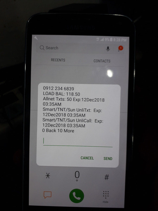

https://i.postimg.cc/kGQNb6dj/20181211-160051.jpg
So ito napo boss Unlock Successful Enjoy po mga paps=))(l:0
