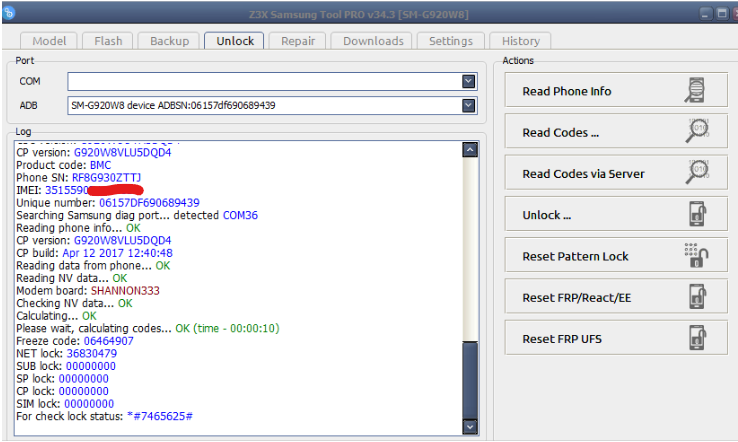

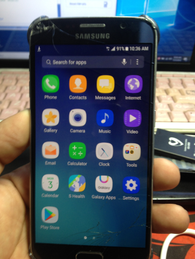

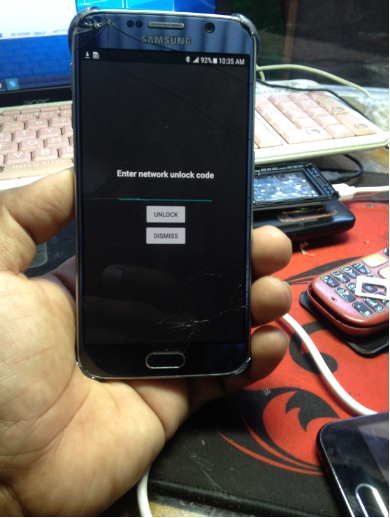

samsung galaxy s6 g920w8 bin5 7.0 no more root or downgrade
readcodes via diag only done
first attempt hindi lumabas ung code
second attempt done.
To read security codes via diagnostic port:
1. Power on the phone.
2. Type *#0808# and select 'DM+MODEM+ADB'.
3. Connect the phone to PC with USB cable, install drivers if needed.
4. Press 'Read Codes DIAG' button to read security codes.
