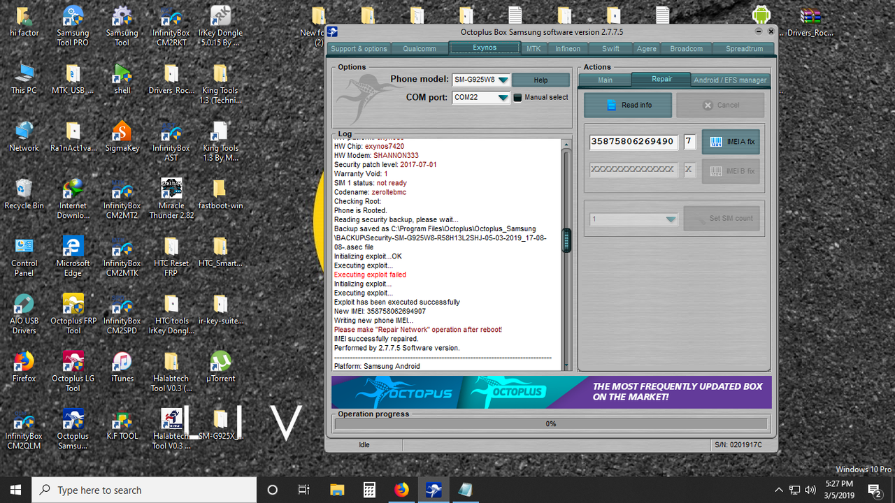

try in octopus logs; by repair imie
Platform: Samsung Android
Selected port: COM8
Selected model: SM-G925W8
Operation: Repair IMEI A
Detected phone model: SM-G925W8
Firmware compiled date: Fri Jul 7 19:02:55 KST 2017
PDA version: G925W8VLS5DQG1
CSC version: G925W8OYA5DQG1
SW version: G925W8VLS5DQG1
Phone SN: R58H13L2SHJ
Android version: 7.0 (NRD90M)
Sales code: FMC
Country: Canada
HW platform: exynos5
HW Chip: exynos7420
HW Modem: SHANNON333
Security patch level: 2017-07-01
Warranty Void: 1
SIM 1 status: not ready
Codename: zeroltebmc
Checking Root:
Phone is Rooted.
Reading security backup, please wait...
Backup saved as C:\Program Files\Octoplus\Octoplus_Samsung
\BACKUP\Security-SM-G925W8-R58H13L2SHJ-05-03-2019_17-08-
08-.asec file
Initializing exploit...OK
Executing exploit...
Executing exploit failed
Exploit has been executed successfully
New IMEI: 358758062694907
Writing new phone IMEI...
Please make "Repair Network" operation after reboot!
IMEI successfully repaired.
Performed by 2.7.7.5 Software version

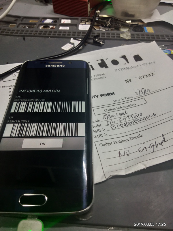

after repair imie
maghahanap na ng network lock so kelangan unlick nalang cya..

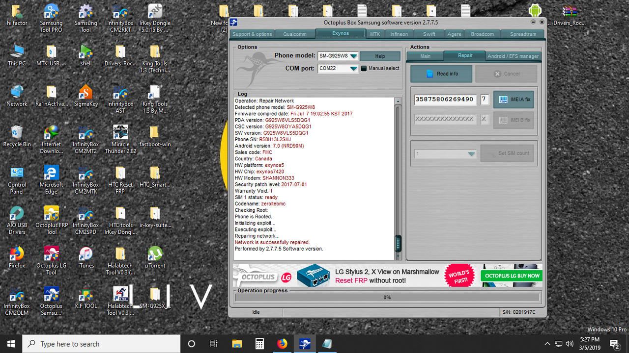

sa signal after unlock need to repair network using octo parin
Selected port: COM22
Operation: Repair Network
Sales code: FMC
Country: Canada
HW Chip: exynos7420
Warranty Void: 1
SIM 1 status: ready
Checking Root:
Phone is Rooted.
Repairing network...
Network is successfully repaired.
Performed by 2.7.7.5 Software version.

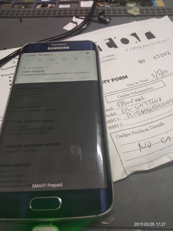

finish product
signal
done...
