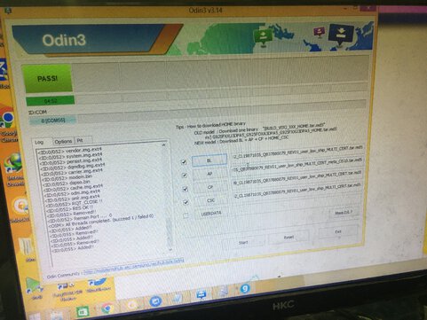

KAYA NAPAG ISIPAN KO NALANG NA E DOWNGRADE CSC DINOWLOAD KO TO https://samfw.com/firmware/SM-G965U/TMB/G965USQS9FUB2
AT AFTER DOWNLOAD FLASH

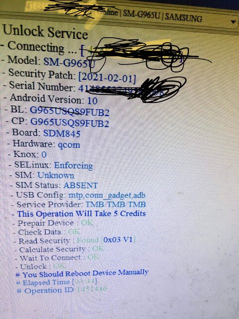

AFTER FLASH TRY ULIT UNLOCK VIA GLOBAL UNLOCKER AND DONE
View attachment 17016View attachment 17023
