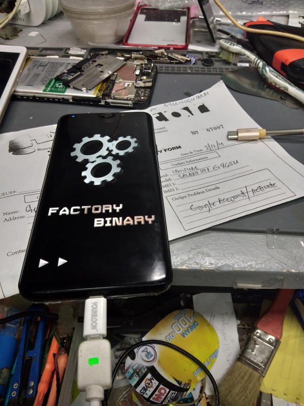

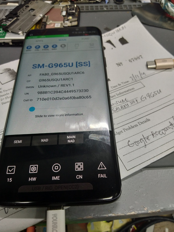

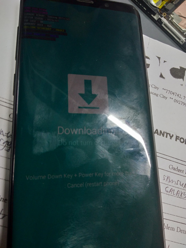

since mataas ang version at b1 sya so need combi file
from support ng z3x madami dun
after download flash combi in odin or z3x (i used z3x for)
go to setting on debugger on oem then make resset the unit...

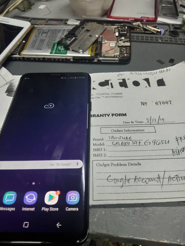

tapos flash sa stock rom...

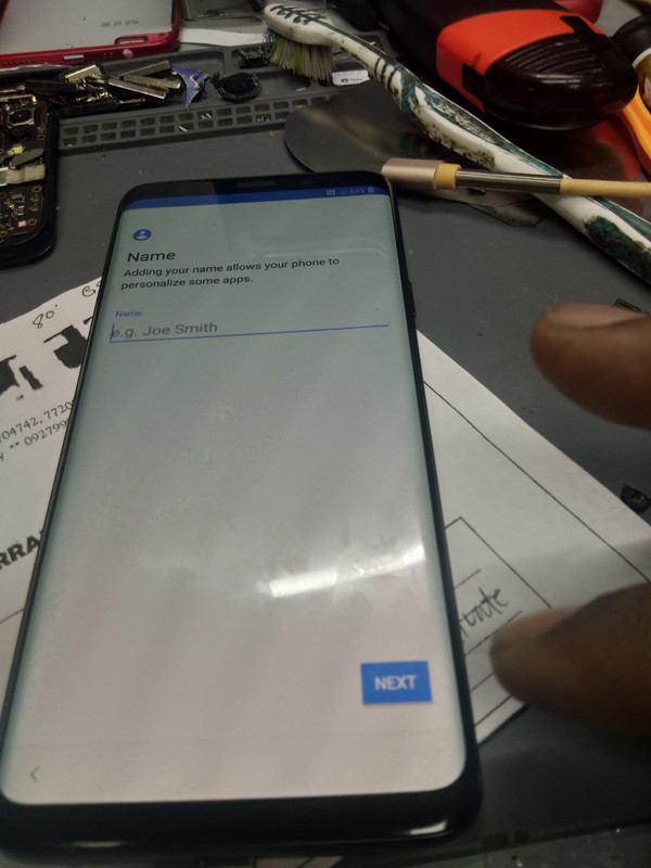

eto na after flashing stock rom

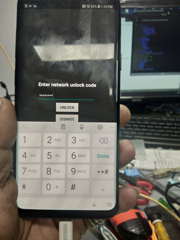

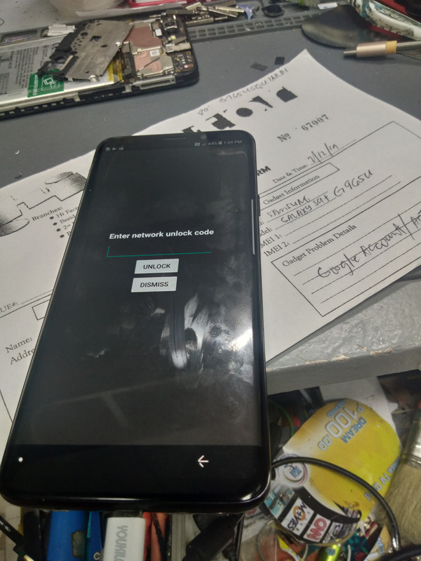

next unlock
need credit for unlocking and consume 10 credit in z3x
need on debuger and oem..

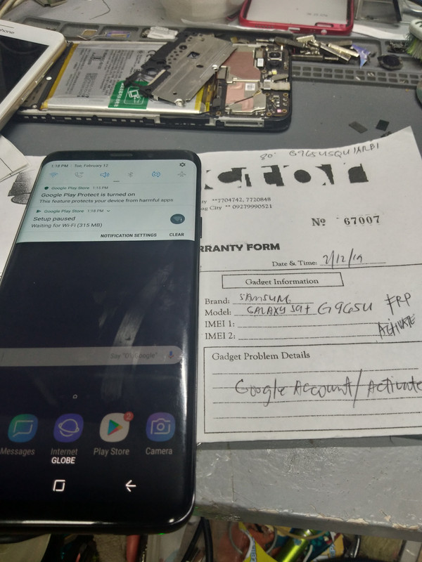

finish product

) psensya na..since mataas ang version at b1 sya so need combi file
strong bold boy namesnext unlock
finish product
