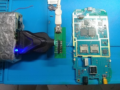

MAGNETIC WIRE
AT MAHABANG PASENSYA HAHA

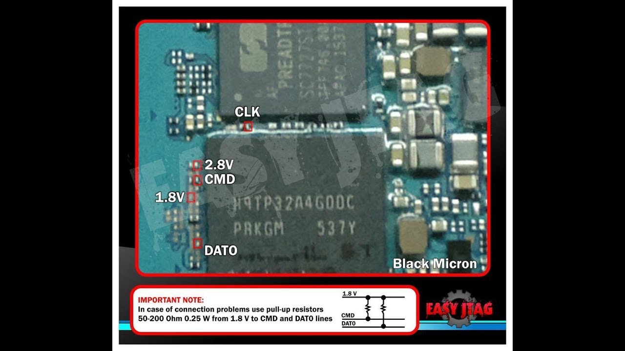

CHECK PINOUTS
AFTER PINOUTS

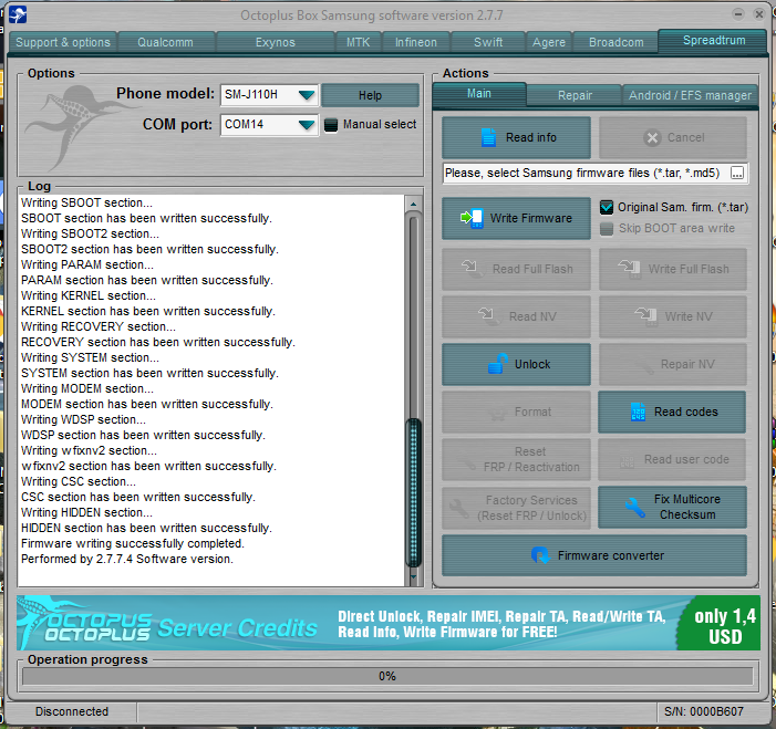

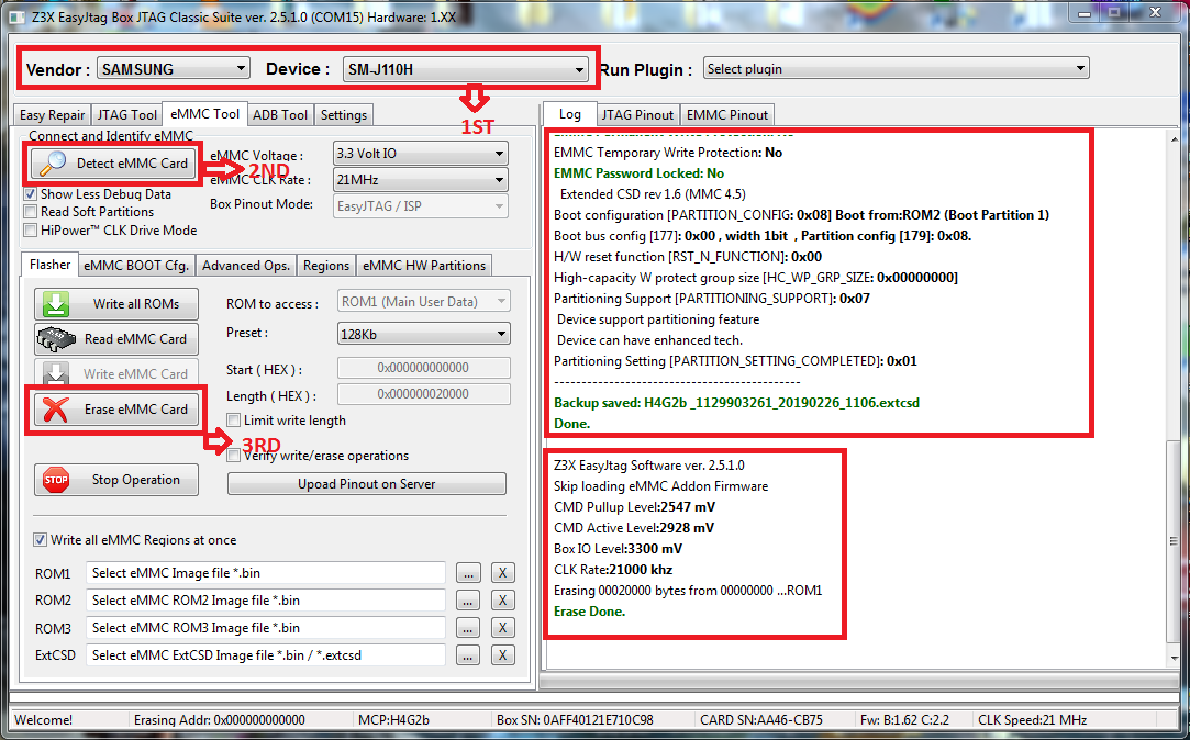

RUN EASY JTAG TOOL
SELECT CORRECT MODEL
CHECK KUNG CONNECTED PINOUTS
PG.OK NA

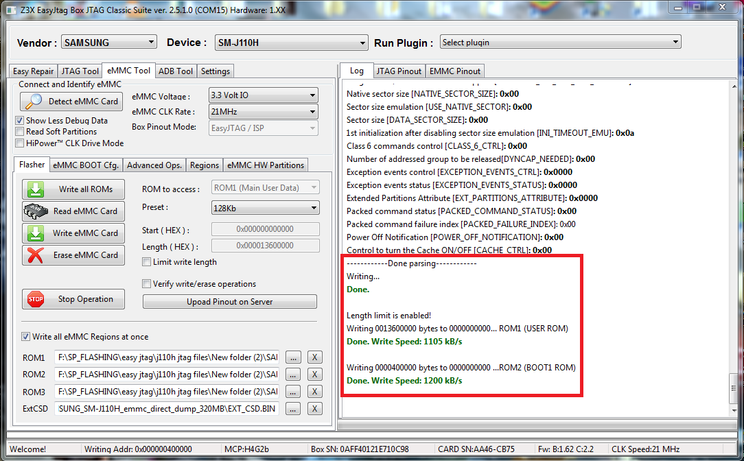

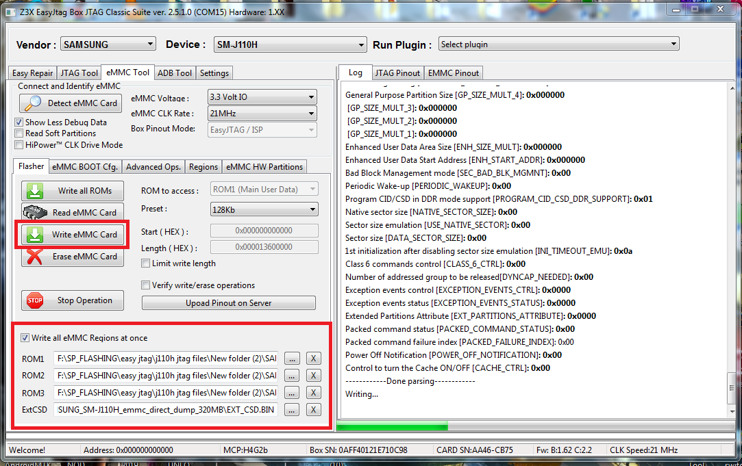

THEN ERASE eMMC CARD
AFTER MA ERASE

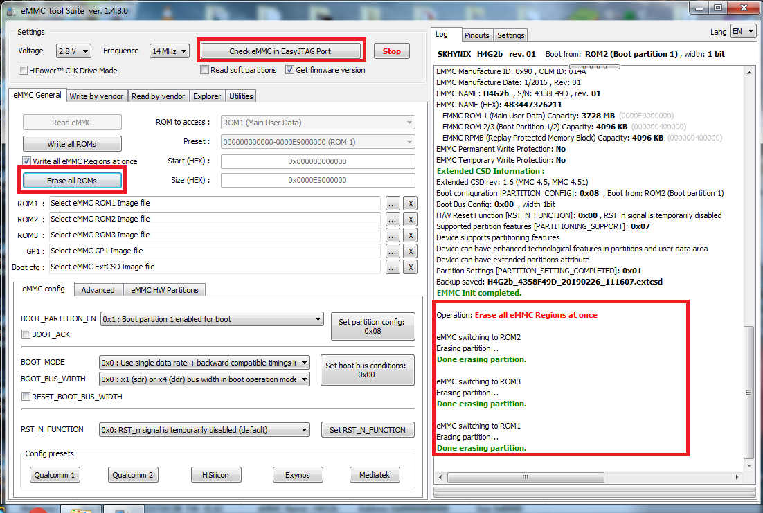

OPEN eMMC TOOL SUITE
TICK; CHECK eMMC in EASY JTAG PORT
THEN ERASE ALL ROM
DOWNLOAD FULL DUMP FILE
https://www.4shared.com/rar/XcPMLGkGgm/SAMSUNG_SM-J110H_emmc_direct_d.html
AFTER DOWNLOAD FLASH DUMP FILE NA
DONE FLASHING DUMP FILE
CHECK KUNG GUMANA HAHA

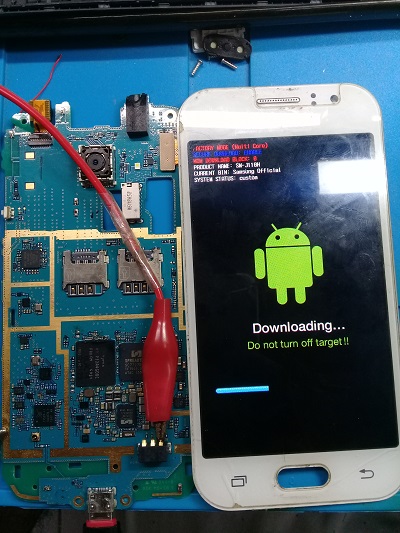

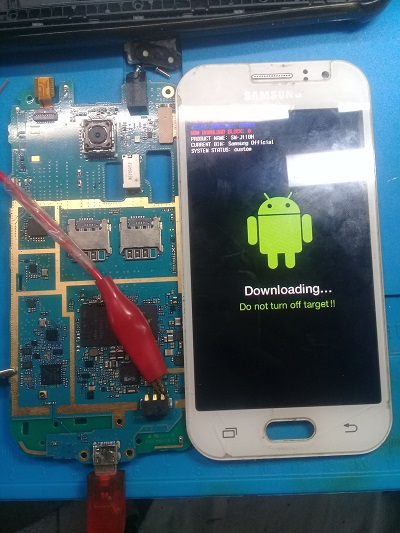

BOOM MY DOWNLOAD MODE NA

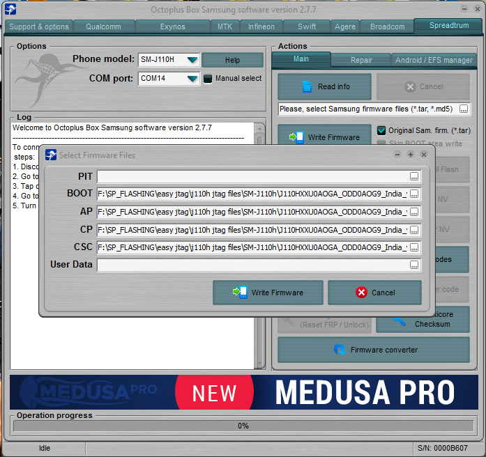

SO NEXT FULL FLASH NA GAMIT 4 FILES

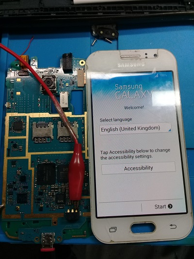

DONE 4 FILES FLASHING

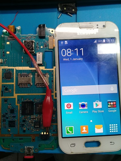

BOOM BUHAY DONE
MASAYA NA MULI SI TUMER
