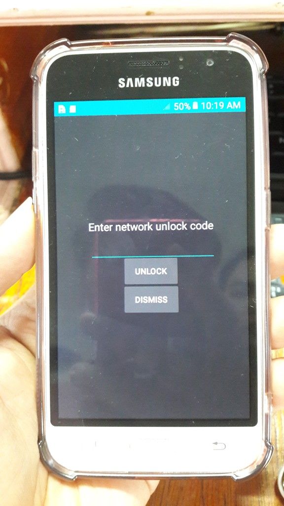

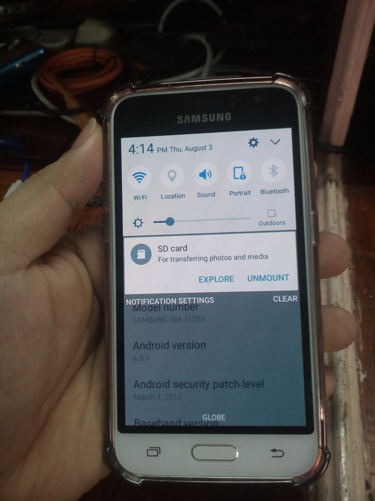

Share ko lng mga boss lock sa at&t

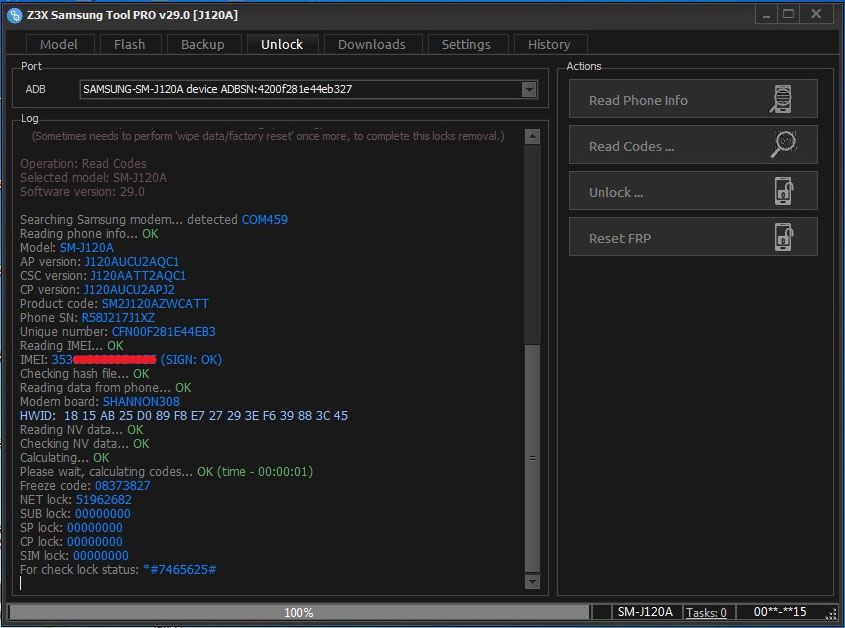

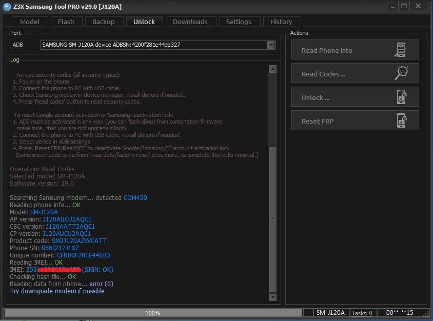

read codes ko error (0) try downgrade modem if possible

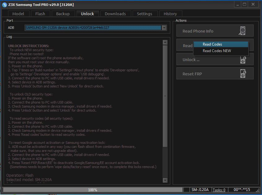

check ko settings new security
"read codes NEW" ko sana pero need pala root, search ako root pero wla ko mahanap

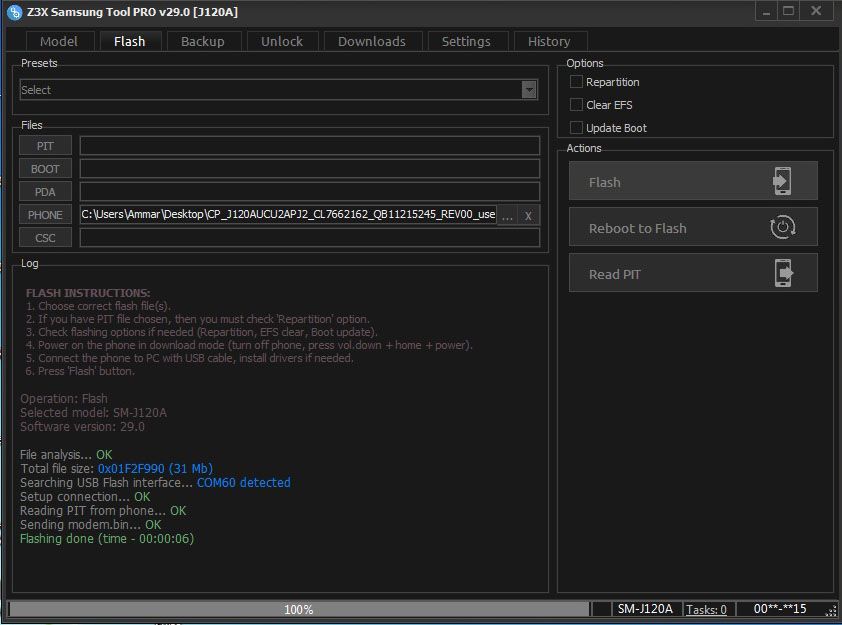

may na search ako na full flash daw buti nlng meron ako nahanap na modem lng
done.. thanks for viewing
e2 ginamit ko modem for downgrade http://www.mediafire.com/file/51e6w4tw9ez8dir/CP_Modem_for_unlock.rar
magiging rooted po ba pag finlash yung modem?
btw, thankyou sa useful thread boss!!!
hindi po boss makikita nyo po sa pic. na read codes pa rn tick ko..
sa read codes NEW un po need ng root.. downgrade modem pra po wla error..
