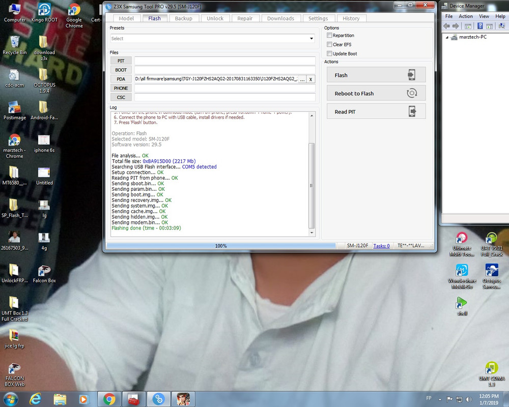

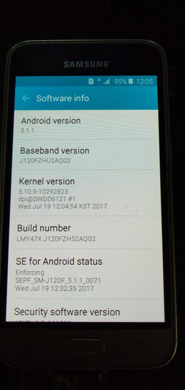

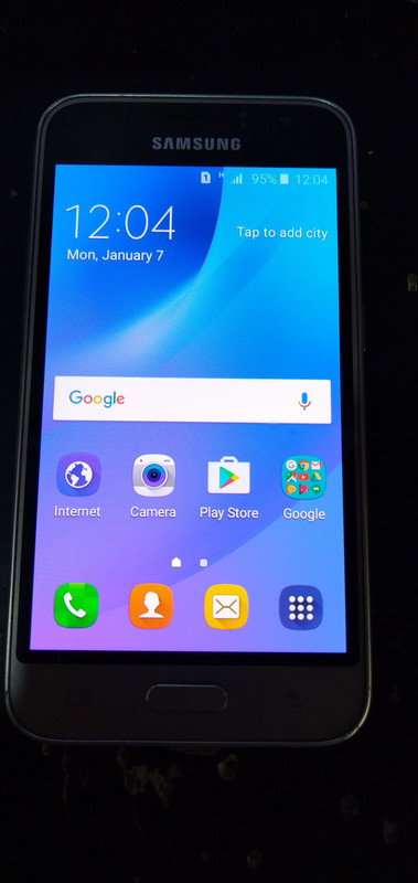

SHARE KO LANG BOSS J1 2016 DI DAW MAGAMIT LAGI NA LABAS C UNFORTUNATELY
KAHIT HARD RESET MO GANUN PARIN .. KAYA DIRECT FLASH NA LANG AKO AT NAG OK NAMAN PO ..
PROCCEDURE PO TAYU UNA TINGNAN ANG EXACT FIMRWARE NITO JUST BOOT TO RECOVERY MODE BY PRESSING VUL.UP-DOWN-HOME NASA TAAS PO SYA ..
ITO PO YUNG FIRMWARE NA DOWNLOAD KO ..
https://samfrew.com/ms/download/Galaxy__J1__/60m8/TGY/J120FZHS2AQG2/J120FZZH2AQG2/
