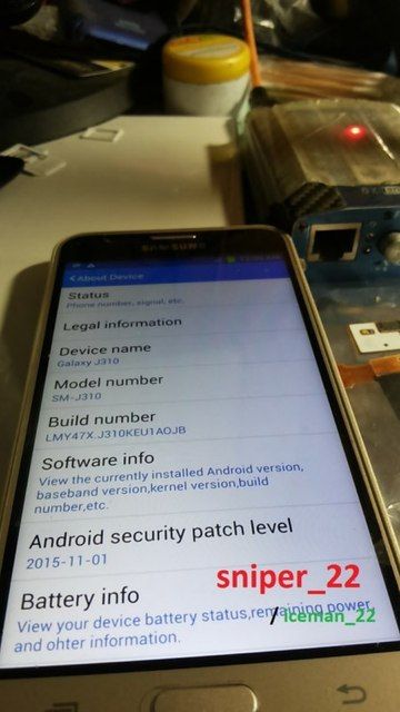

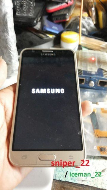

Unit:
SM-J310 J3_2016 (CLONE)
Problem:
Hang (SAMSUNG)
Gadget:
Infinity Box
>Flash via Cm2MTK
>Done
FW:
Problem:
Hang (SAMSUNG)
Gadget:
Infinity Box
>Flash via Cm2MTK

Done!
Elapsed: 00:03:08
Reconnect Power/Cable!
